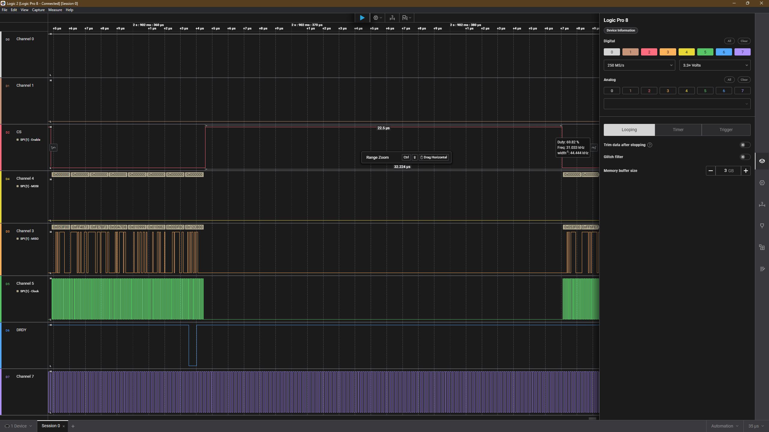

Hello I am trying to sample a ADS131M06 at 32kHz but I am struggling to get the time between SPI transactions below 30us any suggestions?
How many channels are you reading? I.e. what's your frame size/rate?
Six channels, a frame is 8 words, each word is 24bits so 192 bits at a clock speed of 20Mhz.

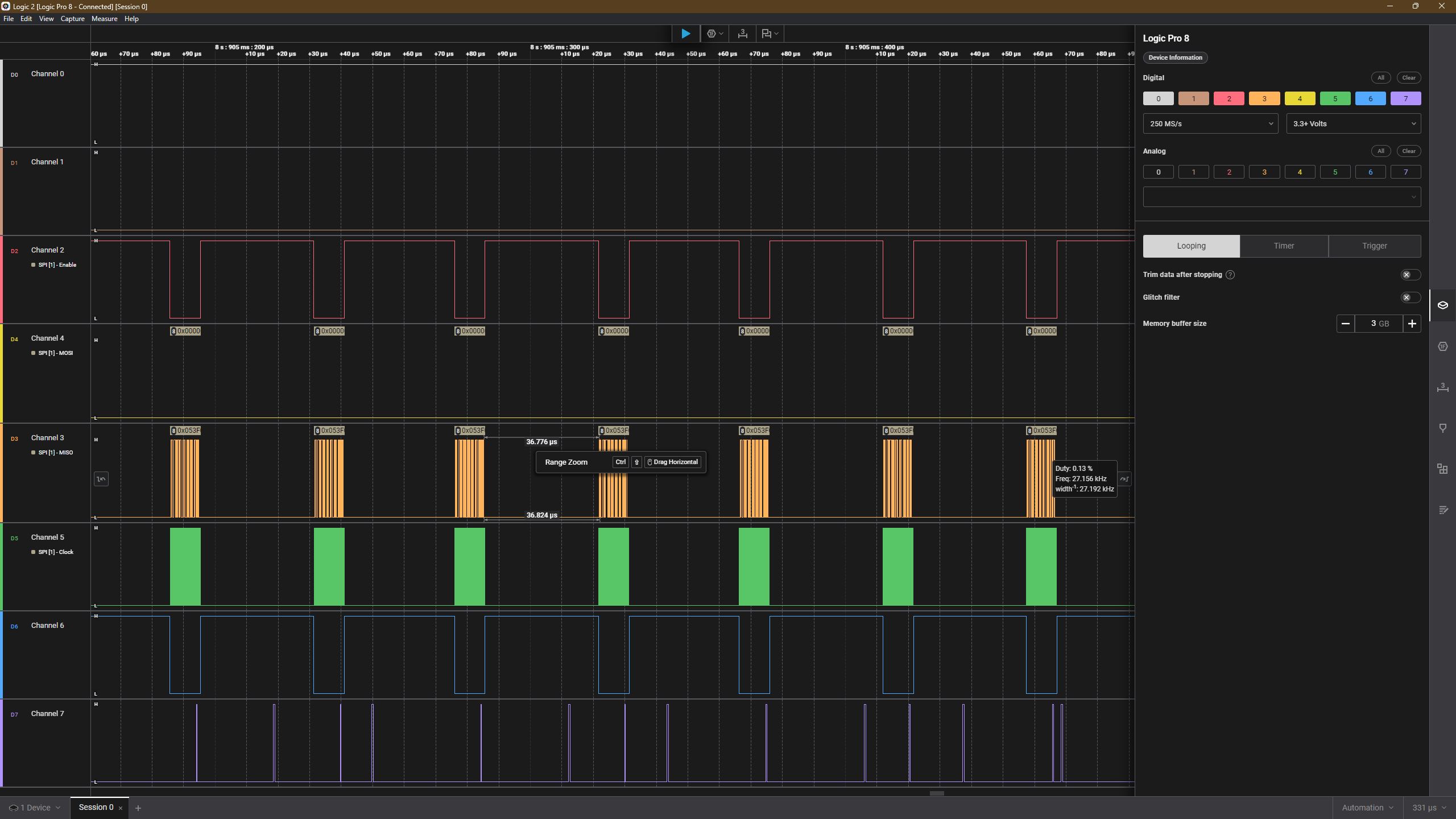

I rewrote the read function to be simpler:
bool readData(adc_channel_data *DataStruct)
    spiSendReceiveArrays(testtx,testrx,24);
    return true;
this reduced the time to ~22.4us between transactions.
I have been informed that the hardware will now require two of the ADS131M06 parts.
Would it be worth while to manually control the CS lines for each of the ADCs or just set up a new SPI device interface Config ?

Would it be worth while to manually control the CS lines for each of the ADCs ... ?
I'd say no.
But the "double-buffering" approach from above may make even more sense with two ADCs.
If the ADCs don't share a common clock source, you'll also have to expect the clocks to slightly drift relative to one another; one ADC might produce more samples per second than the other, so reading them out in sync may become a bit more complicated.
