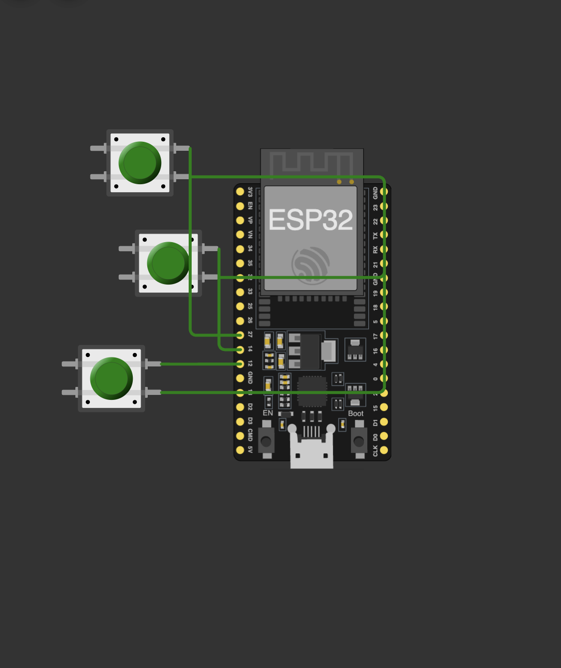

LEFT button → GPIO 27
RIGHT button → GPIO 14
SELECT button → GPIO 12

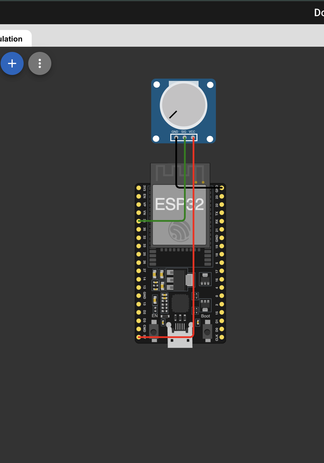

Potentiometer → GPIO 34

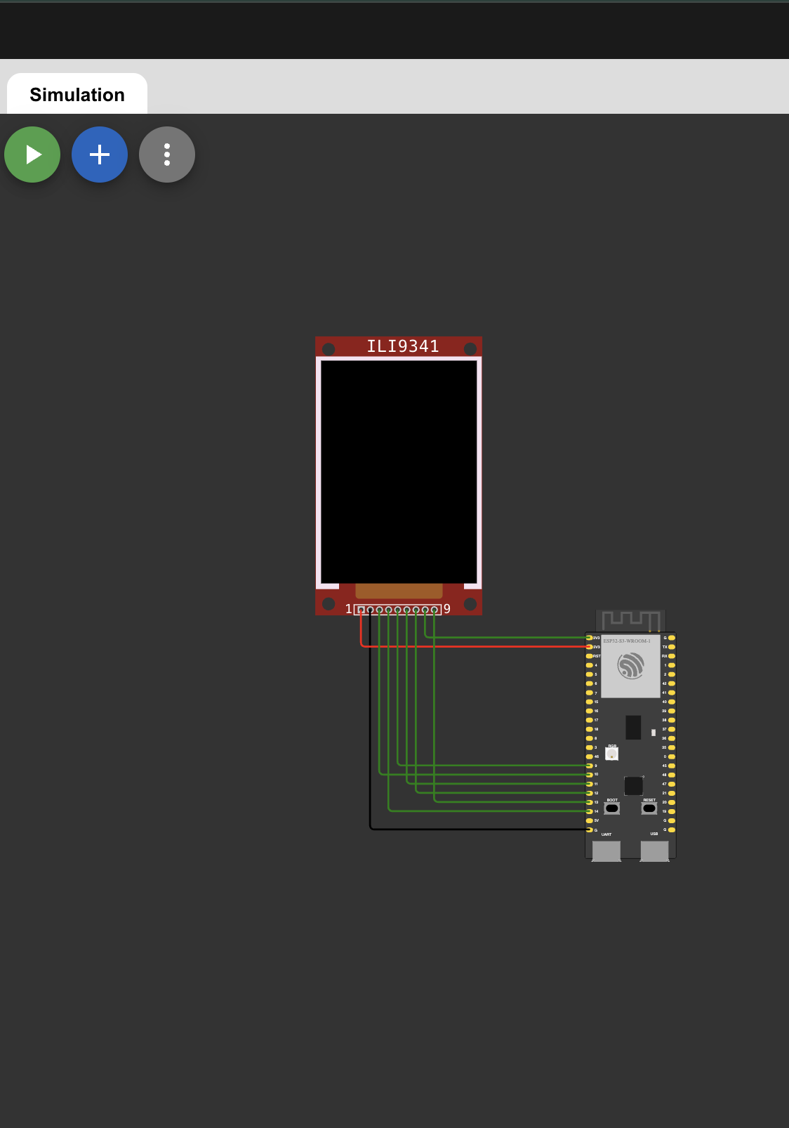

Problem 2 - TFT Display not working:
Using TFT_eSPI library with ILI9341 driver. Configured User_Setup.h with correct pins. Display backlight comes on but no image appears on screen.
Connections:
VCC → 3.3V
GND → GND
CS → GPIO 15
RESET → GPIO 4
DC → GPIO 2
SDI → GPIO 23
SCK → GPIO 18
LED → 3.3V
SCO → GPIO 19
Test code used:
cpp
#include <TFT_eSPI.h>
TFT_eSPI tft = TFT_eSPI();
void setup() {
tft.init();
tft.setRotation(1);
tft.fillScreen(TFT_RED);
delay(1000);
tft.fillScreen(TFT_GREEN);
delay(1000);
tft.fillScreen(TFT_BLUE);
void loop() {}
Questions:
Is User_Setup.h configuration correct for ILI9341?
Could there be a pin conflict somewhere?
Any common mistakes with this display on ESP32?
Problem 3 - Power system not working:
Using TP4056 Type C → 18650 battery → MT3608 boost → ESP32 VIN.
Issues:
TP4056 seems to pass current directly to ESP32 without properly charging battery
MT3608 booster output unstable
18650 battery may be dead
Connections:
TP4056 IN+ → Type C +
TP4056 IN- → Type C -
TP4056 BAT+ → 18650 +
TP4056 BAT- → 18650 -
TP4056 OUT+ → MT3608 IN+
TP4056 OUT- → MT3608 IN-
MT3608 OUT+ → ESP32 VIN
MT3608 OUT- → ESP32 GND
Questions:
Is this wiring correct?
How to check if 18650 battery is dead using multimeter?
Is it safe to power ESP32 directly from TP4056 OUT without MT3608?

No idea about your TFT. If you have an oscilloscope, you could try probing the pins, see if the signals look anything like you'd expect.
