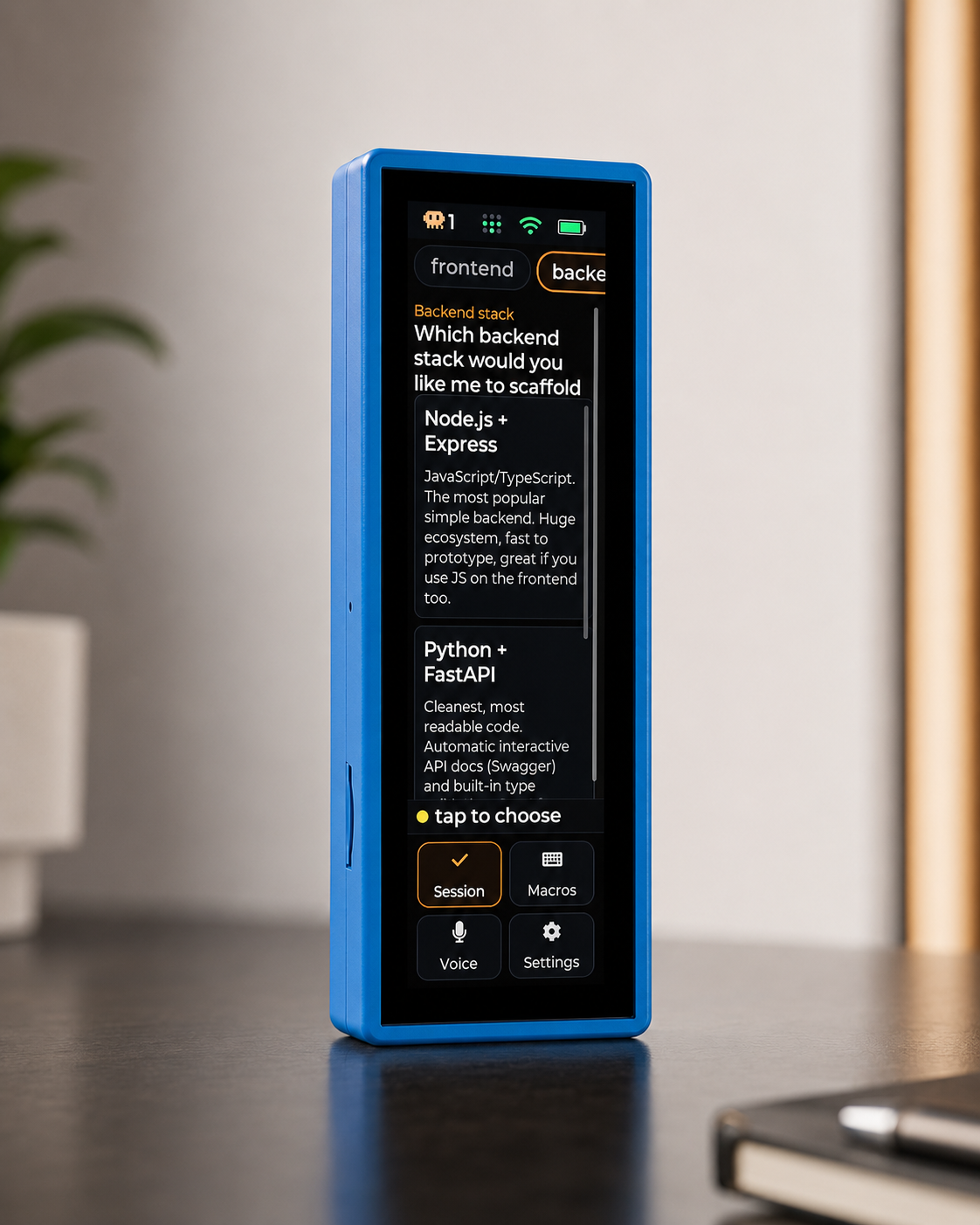

Free/open-source (MIT), personal project, no company behind it: **Claudeq**.
Turns a Waveshare ESP32-S3-Touch-LCD-3.49 (172×640 portrait) into a touch UI for controlling Claude Code (Anthropic's terminal coding agent) sessions running on a host machine.
Firmware: ESP-IDF v5.4.1 + LVGL. Talks JSON-over-WebSocket to a host-side Node "bridge" on port 8787. Discovers bridges via mDNS (_claudeq._tcp); optional Tailscale path for bridges off-LAN.

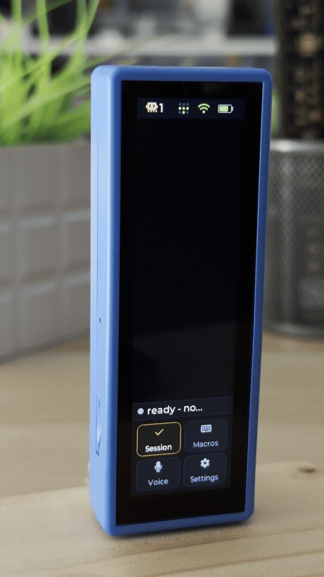

— Power: standby only kills the backlight/panel, keeps WiFi + WebSocket alive, so it wakes instantly on an incoming event rather than needing a reconnect.
— One physical control (BOOT button) does double duty: short press cycles brightness, long press (~1.5s) locks the screen (touch + wake both disabled — pocket-safe), another long press unlocks.
Host side: a `claudeq` launcher wraps `claude` in a named tmux session (so each project becomes a chip on-screen) and a set of Claude Code hooks forwards session events (questions, status, replies) to the bridge.
