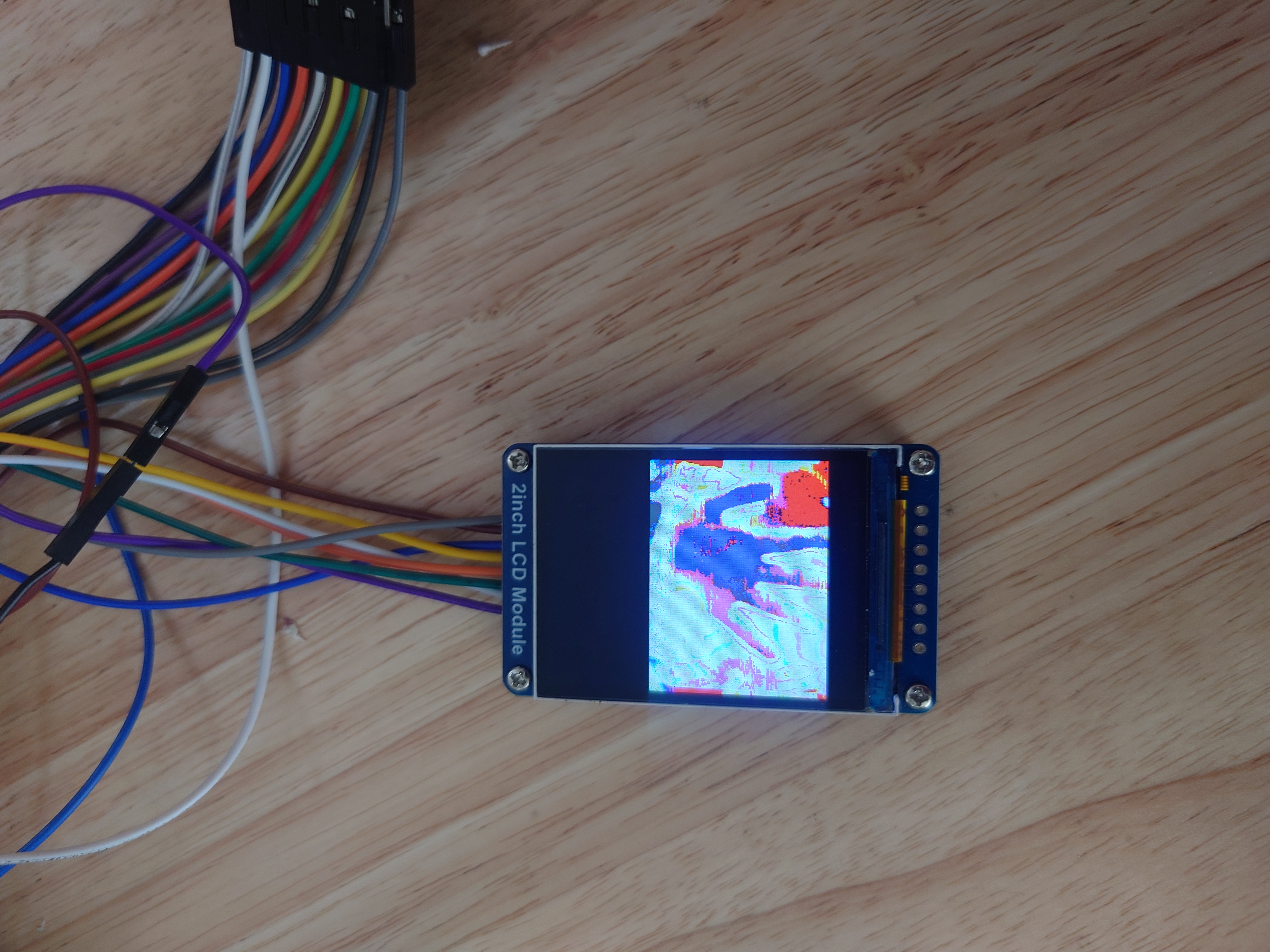

Hardware:
ESP: ESP-32-S3-WROOM-1
Camera: OV5640 (18 pins)
Screen: ST7789V (2inch, 240x320) (8 pins)
Dev setup:
OS: Linux Mint 23
IDE: VS Code
ESP-IDF: v6.0.1
Problem:
I'm trying to get the screen to show the camera, but it's all messed up.
I'm trying (Claude is trying) to modify a dvp_spi_lcd example with no real luck...
I'm attaching the dvp_spi_lcd_main.c, some logs and a photo of the screen.

But I'm stuck on displaying the camera feed...
I might have forgot to mention that the screen is showing what is "supposed" to be me waving my hand in front of the camera.
The colors are all wrong, and it's very grainy.

Postby nopnop2002 » Mon Jul 20, 2026 2:48 am
Is there a possibility that R and B are swapped?
                uint32_t r = ((p0 >> 11) & 0x1F) + ((p1 >> 11) & 0x1F)
                           + ((p2 >> 11) & 0x1F) + ((p3 >> 11) & 0x1F);
                uint32_t g = ((p0 >> 5) & 0x3F) + ((p1 >> 5) & 0x3F)
                           + ((p2 >> 5) & 0x3F) + ((p3 >> 5) & 0x3F);
                uint32_t bl = (p0 & 0x1F) + (p1 & 0x1F)
                            + (p2 & 0x1F) + (p3 & 0x1F);
