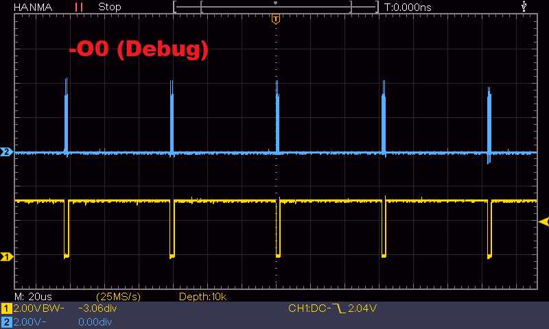

I use the ESP SPI master driver for LCD communication (ILI9341). I observe a huge delay between transmits. Transmitting a byte takes 2 us, but the delay is 60us (Debug optimization). Is it possible to make the delay smaller?

Transfer larger blocks at a time. There's a fair amount of overhead involved in setting up a SPI transfer, and if you use all that overhead to only send one single byte, your throughput will go down the drain.

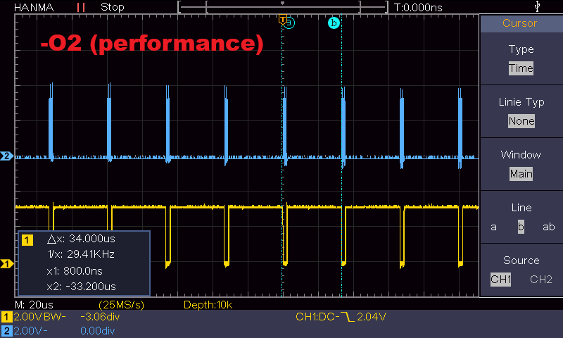

In the meantime, I found it in the documentation. ESP makes a big delay between transmissions. :?
The typical transaction duration for one byte of data is given below.
    Interrupt Transaction via DMA: 34 µs.
    Interrupt Transaction via CPU: 32 µs.
    Polling Transaction via DMA: 17 µs.
    Polling Transaction via CPU: 15 µs.
https://docs.espressif.com/projects/esp ... n-duration
