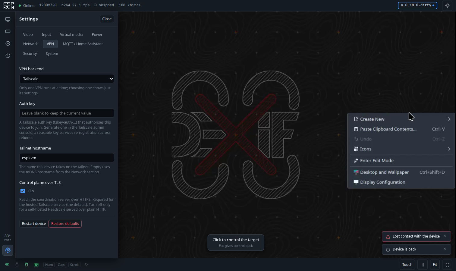

ESPKVM UI

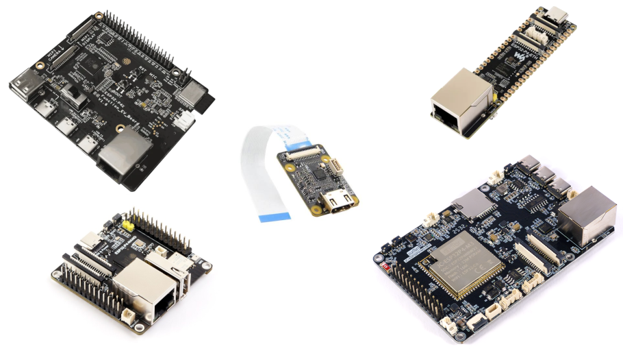

ESP-KVM, an open-source IP-KVM. It captures a target machine's HDMI (HDMI to CSI 2 Adapter C790), presents itself to that machine as a USB keyboard + mouse, and serves both to a browser - so you can reach a box all the way down to its BIOS with no OS and no agent on it.
ESP32 P4(x) boards + C790

  • Also: native Tailscale (and self-hosted Headscale), Home Assistant over MQTT, HTTPS + login, OTA with rollback, and an installable PWA console.
It's built per board - Waveshare ESP32-P4-ETH, Espressif ESP32-P4 Function EV, plus community-tested Waveshare P4 NANO and Guition P4 boards - and there's a browser flasher (esp-web-tools) so you can install over USB with no toolchain.
