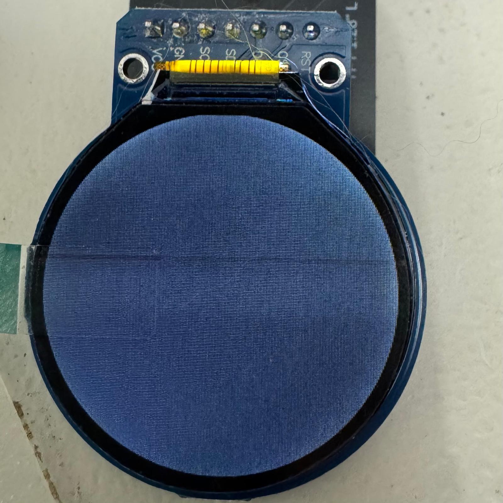

"Hello everyone,
I'm trying to connect a 1.28" GC9A01 TFT screen to an ESP32-S3 (N16R8, 44 pins). I've been stuck on this for 3 days and can't get it to work.
The backlight (BL) is working fine since it's hardwired to 3.3V on the module, and some lines briefly appear on the screen, but nothing else.
Here is my current wiring:
VCC 3,3 V
GND GND
SCL/SCK GPIO15
SDA/MOSI GPIO16
DC GPIO9
CS GPIO10
RST écran GPIO11
BL 3,3 V
MISO Not connected
Here is my code:

Has anyone faced this issue before?
result of my TFT 1.28"
