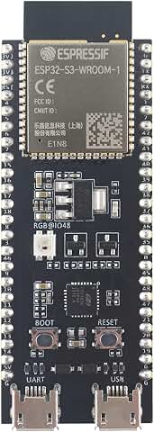

Dev Board
These are 10 pins per inch. Hand soldering is easy. Check the schematic for your board; most likely it expects 5V on the VDD_5V pin. All the Amazon vendors seem to make small changes to the dev boards: pins, leds, size, camera, usb. You might not find a perfect schematic for any particular board; a magnifying glass is helpful.
The dev board has a module soldered to it, at the top in the picture above.

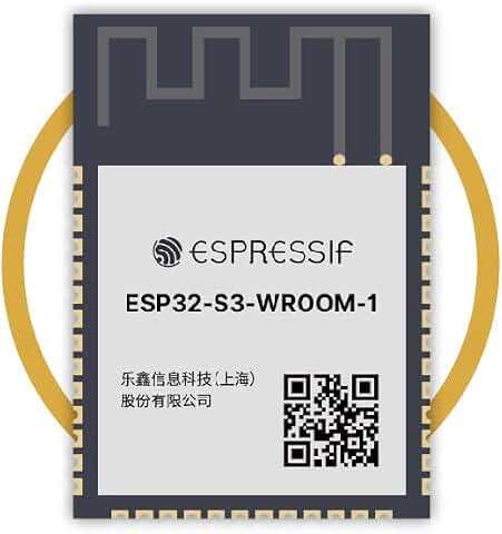

Module
These are 20 pins per inch, hand soldering is possible. Check the module doc; most likely it wants 3.3V. The module has a printed antenna or a connector (printed in these pictures).
If you pry off the metal cover on the module, there are tiny ICs inside, and maybe some external memory.

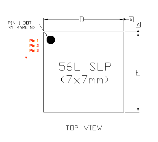

IC (CPU)
The IC is 7mm -- tiny. Beyond my skill level.
