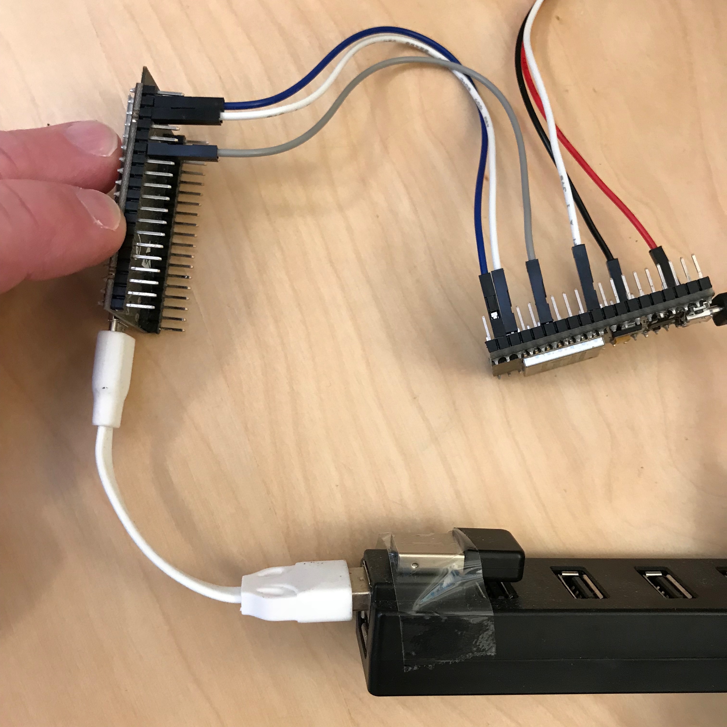

Sorry, didn't get around to it earlier... On second look, I'd like to see what your setup looks like. You're shuffling bits and forth at 3MHz; at rates like this the cabling gets somewhat important.
Not totally sure what you'd like, but I attached a picture of the setup.
I just ran a test at a much slower 8kHs x 16 x 2 = 256KHz.
The data should be:
01,2,3,4,5,6,7,0,1,2,3,4,5,6,7,0,1,2,3,4,5,6,7,0,1,2,3,4,5,6,7...
This is what was actually received:
0,1,1,3,-32766,6,6,7,0,1,2,3,-32766,2,6,7,0,1,2,3,4,5,6,7,0,1,5,20,4100,5,28672,0,-16384,0,17409,1,-32760,3,-32767,0,16452,4,-24574,259,6,7,-14336,0,2,3,4,5,6,7,0,1,2,3,4,5,1,7,0,133,-32762,135,-16384,16385,1,15,2,3,4,5,7,7,2048,1,514,3,-32766,2,-32765,3,0,1,2,3,6,7,0,1,2,3,4,5,6,7,0,1,-32767,1,3,12,8192,16385,-15355,1,0,9,4,4,-32766,2,-32766,3,4,5,6,7,0,1,2,3,4,5,6,7,0,1,-32766,4,-32768,512,-32766,2,6,7,0,1,2,3,4,5,6,7,16384,2,1,3,2,5,0,1,2,3,4,5,6,7,0,1,2,3,4,5,-32765,3,-24508,1,16384,3,4096,0,4,5,-32765,7,-32768,512,1,7,1,3,36,277,-32765,3,0,1,2,3,4,5,6,7,0,1,2,3,-32734,2,-32767,65,3,7,2,3,4,5,6,7,-32768,0,2,3,-32766,16386,-32765,2055,2,3,4,5,6,7,0,1,2,3,4,5,6,7,0,1,-32764,5,-32767,3,16448,1,0,0,-24574,2,7,7,0,1,-16384,8192,1,5,1,71,0,8193,2,3,4,5,6,7,0,1,2,3,4,5,6,7,-16128,16385,2,16419,-32767,2,4,5,6,7,-32768,0,2,5,6,7,0,1,-32766,2066,-32765,3,0,1,2,3,4,5,6,7,0,1,2,3,20480,129,-14848,1,8200,0,-32764,5,22,2566,7,57,6,14,10240,0,-32768,3,4,5,6,7,0,1,2,3,4,5,6,7,0,1,1,3,6,7,2,7,16385,1,6,7,512,1,2,259,-32766,2,6,7,-32768,0,2,3,4,5,-32768,0,2,3,4,5,6,7,0,1,2,3,4,5,-32767,3,8704,16385,9216,0,24576,3,2055,7,4096,3,2,5,6,30,0,1,6,7,0,1,2,3,4,5,6,7,0,1,2,3,4,5,4,1,31745,-14271,-32767,1,4,5,-32766,3,0,1,0,1,2,3,4,5,-32765,3,0,1,2,3,4,5,-32765,3,0,1,-32767,1,4,5,6,7,0,1,2,3,4,5,6,7,16384,1,133,5,-16384,0,-32767,3,-32759,2,6,3,-32768,1,-32766,2,10,10,-32767,129,2,3,4,5,6,7,0,1,2,3,4,5,6,7,2,4101,-32767,1,-32765,3,1,3,4,5,6,7,0,1,258,3,4,5,-32765,7,-32764,1029,6,7,0,1,2,3,4,5,6,7,0,1,1,3,2,14,-32765,3,0,1,-32768,1,-32637,3,6,28,-28672,-32768,-32764,5,14,206,4,5,6,7,0,1,2,3,4,5,6,7,0,1,30,112,-32768,128,-16384,128,16384,2,6,7,0,1,4,5,6,7,4096,1,8192,16385,6,7,0,1,2,3,4,5,6,7,0,1,2,3,3,5,1046,7,-32767,515,-31741,7,1,3,6,7,6,7,0,1,2,3,4,5,6,7,0,1,2,3,4,7,2,5,2,3,2,517,6,7,0,1,132,5,6,7,0,1,-16384,0,-32766,10,3,7,-32768,1,2,3,4,5,6,7,0,1,2,3,4,5,6,7,0,1,8,0,8192,1,4098,-32768,16385,-16383,-32768,0,129,515,2,5,-32763,3,-16384,2049,-32764,5,2,3,4,5,6,7,0,1,2,3,4,5,6,7,0,2,2,3,4,5,3,7,-32768,0,1,3,-32766,2,6,7,2,3,4,5,6,7,0,1,2,3,4,5,6,7,0,1,2,3,6,7,16448,1,-32766,2,-32768,3,0,1,2,3,4,5,6,7,0,1,2,3,4,5,1,1,-32745,2556,518,30,258,16389,4,5,6,7,0,1,-32767,1,4,5,-32768,0,-32768,1,-32767,1,0,1,2,3,4,5,6,7,0,1,2,3,3,-32740,19,7,4,-32748,-32767,1,2,5,-32768,0,-32768,1,-16384,2080,4,2051,5,1034,6,7,0,1,2,3,4,5,6,7,0,1,1,3,8192,4096,0,7,-32766,5,4,5,-32765,3,0,1,2,3,-32734,2,134,7,0,1,-16384,1,4,5,6,7,2,3,4,5,6,7,0,1,2,3,4,5,6,7,0,9,16386,2,16386,3,0,1,-32768,1,2,3,4,5,6,7,0,1,2,3,4,5,6,7,-32767,7,0,257,-32767,2,0,1,8194,131,-32764,5,7,7,2,3,4,5,6,7,4,1,-32768,1,4,5,-32765,3,0,1,2,3,6,7,0,1,2,3,4,5,6,7,0,1,1,3,-32765,3,32,1,-14335,1,-32735,3,20481,258,-32767,3,3,8194,-16381,3,14,32,4,5,-16382,2,3,263,-32767,1,-32766,18,4,5,6,7,0,1,2,3,4,5,6,7,0,1,278,-32744,-16384,68,2,3,4,5,6,7,0,1,257,3,4,5,0,7,-30720,0,-16384,0,-32766,2,-32765,3,0,1,2,3,4,5,6,7,0,1,2,3,4,5,-32637,131,1,8195,-32730,8198,-16384,-32511,6,7,-32767,518,1,259

- Physical_Layout
- IMG_9949.JPG (1.11 MiB) Viewed 6060 times
- Posts: 9052
Re: I2S data corruption?
Thanks, I was looking for such an image. Do you have the grounds of the two boards connected? I can only see three wires there, not sure if the ground is one of them... if you do not have that, the return current needs to go through the big loop of USB cables, hub etc, and any interference picked up there kills your data integrity. To solve it, just use another jumper wire to connect the grounds directly.

WRT Grounding: Oh boy, I should have thought of that
I'd been trying to figure out why I was seeing such strange data from two I2S microphones which I posted about here: viewtopic.php?f=14&t=1506.
Per your suggestion: added the ground, re-ran the slower 8kHs x 16 x 2 = 256KHz test and got perfect data:
4,5,6,7,0,1,2,3,4,5,6,7,0,1,2,3,4,5,6,7,0,1,2,3,4,5,6,7,0,1,2,3,4,5,6,7,0,1,2,3,4,5,6,7,0,1,2,3,4,5,6,7,0,1,2,3,4,5,6,7,...
