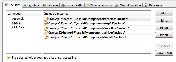

Hello guys,
I am a total newbe to this kind of programming and I use Windows 7 64 bit.
I have the ESP32 DevKit V1 and I used the instructions to set up eclipse from here:
http://esp-idf.readthedocs.io/en/latest ... ndows.html
Afterwards I wanted to build and flash the following code:
/* Blink Example
#include <stdio.h>
#include "freertos/task.h"
#include "driver/gpio.h"
#include "sdkconfig.h"
/* Can run 'make menuconfig' to choose the GPIO to blink,
   or you can edit the following line and set a number here.
#define BLINK_GPIO CONFIG_BLINK_GPIO
void blink_task(void *pvParameter)
    /* Configure the IOMUX register for pad BLINK_GPIO (some pads are
       muxed to GPIO on reset already, but some default to other
       functions and need to be switched to GPIO. Consult the
       Technical Reference for a list of pads and their default
       functions.)
    gpio_pad_select_gpio(BLINK_GPIO);
    /* Set the GPIO as a push/pull output */
    gpio_set_direction(BLINK_GPIO, GPIO_MODE_OUTPUT);
    while(1) {
        /* Blink off (output low) */
        gpio_set_level(BLINK_GPIO, 0);
        printf("LED OFF");
        /* Blink on (output high) */
        gpio_set_level(BLINK_GPIO, 1);
        printf("LED ON");
void app_main()
    xTaskCreate(&blink_task, "blink_task", configMINIMAL_STACK_SIZE, NULL, 5, NULL);
I also used this instruction to set the include paths right:
http://www.lucadentella.it/en/2016/12/1 ... 3-eclipse/
This instruction is pretty similar to the upper one, except for the Build Settings.
After cleaning, I builded the project manually and received the following error:
"warning, -s option given but default rule can be matched"
And four warnings that my include paths for the library headers are wrong, though I double checked them and they seem right. (I've attached a picture showing them).
When I now try to flash the code, I get the following error:
"make: *** [/home/LP/esp-idf/components/esptool_py/Makefile.projbuild:53: flash] Error 1"
Any suggestion what could be the problem? I checked the settings like IDF-path etc. several times but cannot find any mistake.
I am helpful for everything cause I totally stuck.
Kind regards
slev1n
