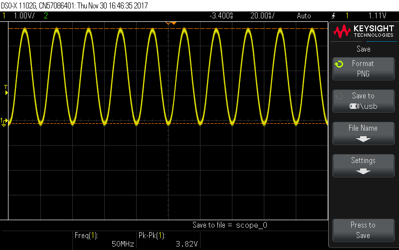

I managed to generate clean 50MHz using the Audio PLL and I2S using the following code. Signal is routed to GPIO0.

And your code works as well once the order of initialization is modified. See below code which outputs nice 50MHz on GPIO16.
    // Enable the I2S peripheral
    periph_module_enable(PERIPH_I2S0_MODULE);
    // Configure Audio PLL to 100 MHz.
    // Note: sdm2 seems limited to 12 for some reason.
    //             f_xtal (sdm2 + sdm1/2^8 + sdm0/2^16 + 4)
    //    f_out = ------------------------------------------
    //                          2 (odiv + 2)
    // with f_xtal = 40MHz, sdm2 = 6, sdm0 = 0, sdm1 = 0, odir = 0
    rtc_clk_apll_enable(1, 0 /*sdm0*/, 0 /*sdm1*/, 6 /*sdm2*/, 2 /*odiv*/); // 50 MHz
    REG_SET_FIELD(EMAC_EX_CLKOUT_CONF_REG, EMAC_EX_CLK_OUT_H_DIV_NUM, 0);
    REG_SET_FIELD(EMAC_EX_CLKOUT_CONF_REG, EMAC_EX_CLK_OUT_DIV_NUM, 0);
    REG_CLR_BIT(EMAC_EX_CLK_CTRL_REG, EMAC_EX_EXT_OSC_EN);
    REG_SET_BIT(EMAC_EX_CLK_CTRL_REG, EMAC_EX_INT_OSC_EN);
    // Output EMAC_CLK_OUT on GPIO16
    PIN_FUNC_SELECT(PERIPHS_IO_MUX_GPIO16_U, FUNC_GPIO16_EMAC_CLK_OUT);
