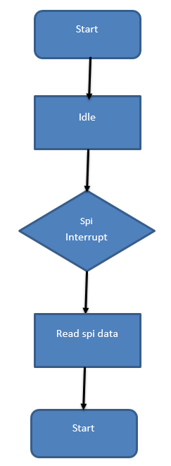

Thank you for your response, but i want the ESP32 wait for spi communication initiated by the master.
in the example code of spi communication between ESP32s in esp-idf, the function used is:
spi_slave_transmit(HSPI_HOST, &t, portMAX_DELAY); and this transmit data.
to simplify the flowchart of the example i am looking for is:
Start -> Idle -> if SPI interrupt -> Read spi data -> End
Thank you in advance for your help.

- Posts: 8926
Re: SPI slave communication with another microcontroller
Spi_transmit will actually block until the master has exchanged data with the slave. No need to mess around with interrupts specifically, the driver will take care of that.

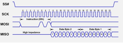

I come back to you, about the spi transaction, My esp32 works as slave, I need SPI Read transaction that the slave begins transmitting data on the MISO After receiving a "read commad" as shown in the folowing figure:

- Posts: 8926
That unfortunately is not possible using the current driver. The SPI slave interface does have another mode of operation which can use the mixed instruction/data concept that's shown in your picture (and the hardware for that is documented in the technical reference manual), but we do not have a driver for it. With the help of the technical reference manual, you should however be able to write your own.
