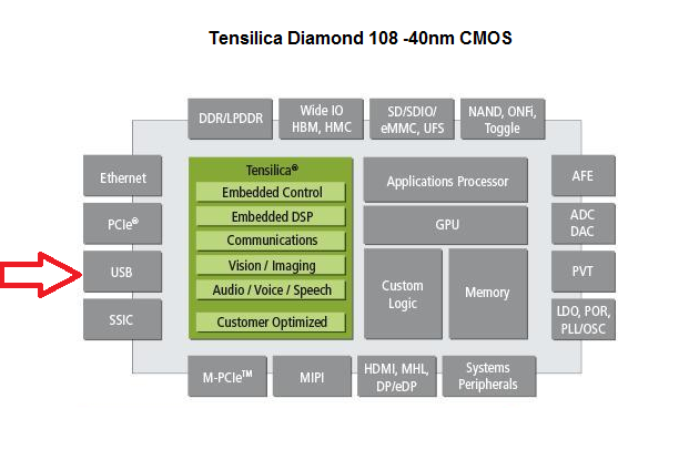

Postby rudi ;-) » Wed Jan 24, 2018 1:45 am
i think, this suggestion is done here in the list more times,
but i want make it again that this becomes a high priority
that it will not be forgotten because it would be incredibly important
not only because of technical requirements / wishes,
but to keep up in the competition.
- USB HOST / DEVICE ( OTG ) >= 2.0
so please don't burn out it again from 108 basic'S if you use this architectur as base
Diamond_WP.pdf
(683.36 KiB) Downloaded 839 times
thanks

  • Rudi: We don't start out with an existing system and then remove parts :) that's not how it works. If you buy an Xtensa, all you get is the capability to generate a version of the bare core. All the other peripherals, you'll have to pay for the IP and integrate it into whatever system you need; for stuff like USB2.0 (mostly high-speed) you have the added issue that the analog bits of the PHY then also need to fit into whatever analog process you use. Still, we know that USB is a much-requested thing, and we'll try to at least meet you guys halfway there.
