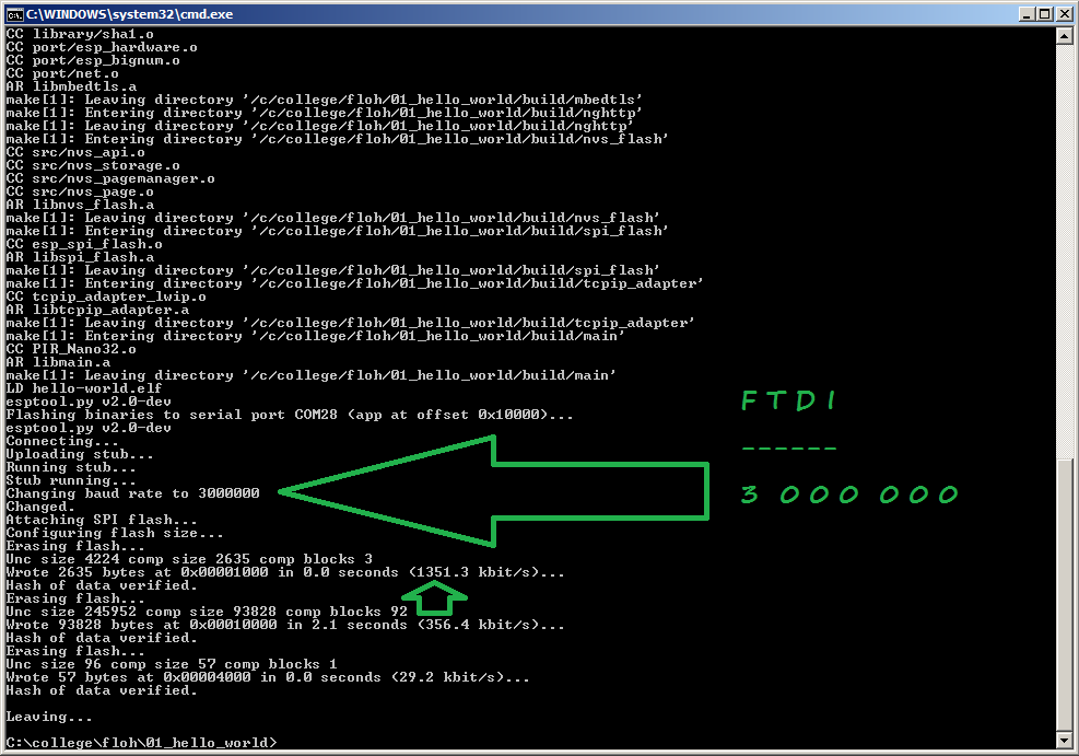

FTDI 231XQ was used on NANO32 and support flexible range 183.1 baud to 3,000,000 baud.
The FT231X supports all standard baud rates and non standard baud rates from 183 Baud up to 3 Mbaud

For flashing large amounts of data the bottleneck is currently decompression speed (note the 356kbit/sec for the larger image in the screenshot). Although I agree it'd be nice to have higher UART speeds on the dev boards.

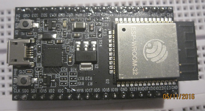

yes - i got a parcel last days from espressif - i hoped sooooooooo for the RED DevKit J ( aka ESP-WROVER ) ... :lol:
i get the newest DevKitC V2 .. with Cased WROOM32.. but i test just in time - i think this is monday modul,
after flashing, the boot is in a while.. i must try again next days.
so i think we must live with 921600 with this Silabs

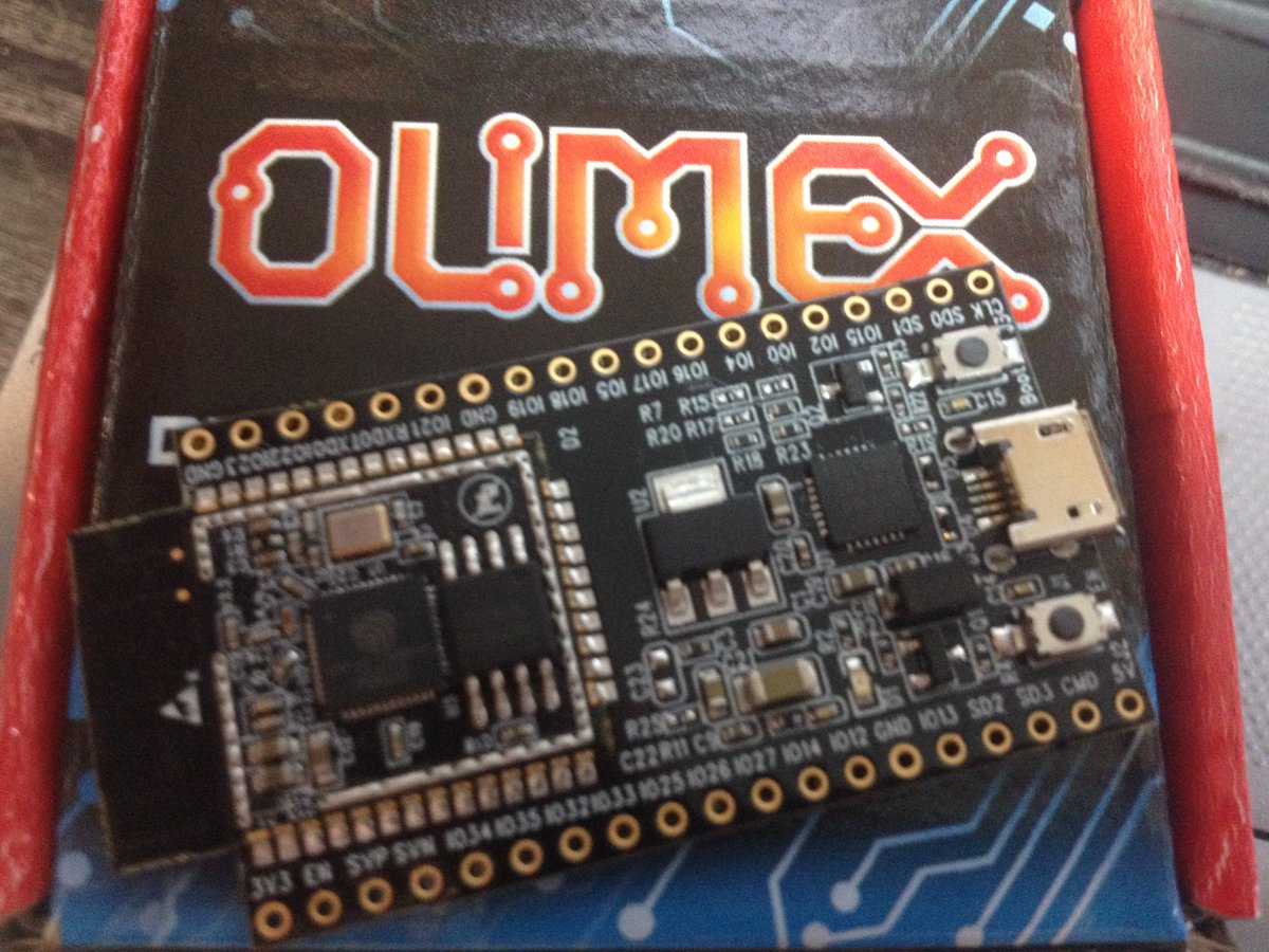

olimex DevKitC V2...
i see 'K' on trace ( PCB antenna ) on olimex - same in ESP-32S from AI Thinker
and no Case on the Modul

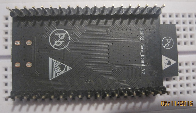

and the newest from espressif V2 i get .. change only Cased or more? do you know? -
ESP_Angus
Posts: 2344
Re: Silabs CP2102 on DevKitC V2 dont support Baud more as 921600 ?
Postby ESP_Angus » Mon Nov 07, 2016 12:05 am
rudi ;-) wrote: and the newest from espressif V2 i get .. change only Cased or more? do you know? -
I believe the only difference is the RF shielding can on the module.

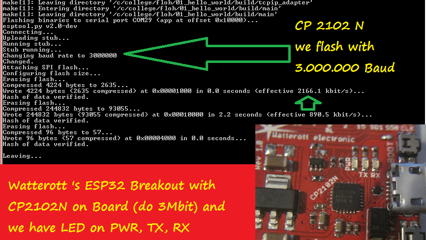

https://twitter.com/welectronic/status/ ... 2305934336
Silabs CP2102 N
Site 15:
cp2102n-datasheet.pdf
(925.96 KiB) Downloaded 720 times
did the trick on watterott's new ESP32 Breakout
we have :
300, 600, 1200, 1800, 2400, 4000, 4800, 7200, 9600, 14400,
16000, 19200, 28800, 38400, 51200, 56000, 57600, 64000,
76800, 115200, 128000, 153600, 230400, 250000, 256000,
460800, 500000, 576000, 921600, 1000000, 1200000, 1500000,
2000000, 3000000
The baud rate generator is very flexible, allowing the user to request any baud rate in the range from 300 baud to 3 Mbaud.
