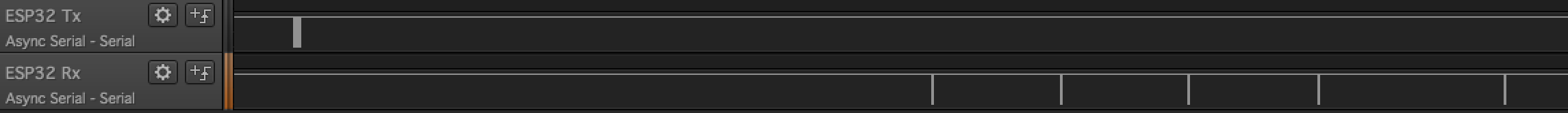

I'm not sure if this is a hardware/soldering issue or not, but I've never received a response to any message from esptool-esp31.
My module boots normally to the demo app. If I short GPIO0 to GND I get flash download mode, which spits this out of U0TXD:
However, no amount of tinkering with esptool-esp31 or esptool32 gets a response from the ESP32. I've attached a screenshot showing see the module booting and my FTDI cable pushing bytes several times without response. My command was:
Any thoughts? Am I not poking enough GPIO lines - not in the right mode?
ets Jul 5 2015,rst cause:1, boot mode:(13)
. _stack_sentry: 0x3fffe1d0, . __stack: 0x40000000,
. _bss_start: 0x3fffcd48, . _bss_end: 0x3fffe1d0,
. _data_start: 0x3fffc000, . _data_end: 0x3fffc864
./esptool32.py --port /dev/tty.usbserial-FTH159YK read_mac
- esptool32_deaf.png (23.33 KiB) Viewed 26064 times
Re: Flash Tool
i can confirm that GPIO0 to GND is all you need. withthe console output you posted, it looks like you get into bootloader fine.
can you post the error you get?
