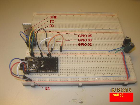

hi
only a question, my first start up starts in few minits:
have checked soldering and board pins, all ok.
have we a bootloader prompt to see ( identify as bootloader mode ) in terminal or comes blank screen? if bootloader prompt, what / how does it say / looks it?
i will start then:
connect GND,
connect 3.3
connect EN to 3.3
GPIO0 to low ( GND )
GPIO2 to low ( GND )
toogle EN 1-2 time
then bootloader must come, right?
flashing the empty flash ic
with posted esptool
then boot ap demo
connected GND,
connect 3.3,
toggle 1-2 EN to 3.3 ( have we no Rest Pin? )
GPIO0 to high ( 3.3 )
right?
till later, will try it now in few minits.

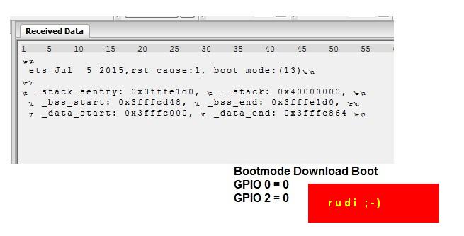

btw:
this was one output i toogle pin EN:
"esp31" is talking with me ;-)

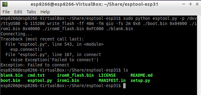

btw, need we flash_write "esp_init_data_default.bin" for the demo_app?
btw:
get no connect with the esptool_esp31.py
2015-12-17 01-32-38-481.jpg (101.13 KiB) Viewed 21759 times
tip, proposal?
try to analyz with logic now.

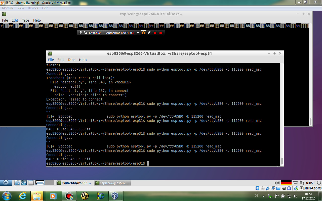

have test more variants after logic.
first time, the esptool have no response,
after little tests and patching then MAC is response:
bandicam 2015-12-17 04-51-20-125.jpg (271.9 KiB) Viewed 21738 times

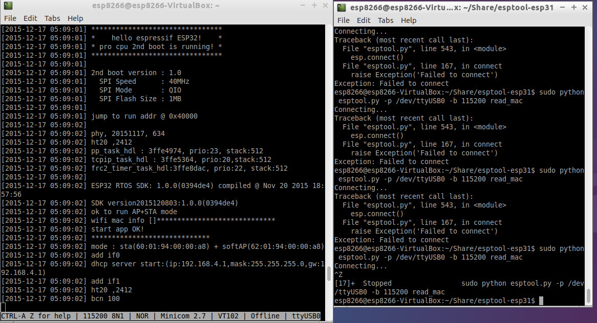

after next time, boot mode with demo app was response
bandicam 2015-12-17 05-13-56-365.jpg (363.67 KiB) Viewed 21738 times
will check this evening again, why i can't go in bootmode 11 and upload the files.

done!
but i cant upload firmware, why, this must be clear at evening.
@bienvenue
try to deconnect the TX/RX to the USB if you reconnect the modul
What did you do to get it to work, specifically? (The "little test and patching".)
hi bienvenu, sry for wrote name wrong before,
i "massacred" the modul :lol:
i picked it out from [EDIT right word, EDIT add Picture of ] breadboard,
bobbed in into again, and same again, same again,one time then the app was boot, so i stopped this. Soldering Modul on Breakout was ok,but think the U0TXD makes worse ( see 8digit toogle switch table 1-2, the U0TXD on boot SPI is High Level )then i connect gpio0 to low, deconnect EN from high (3.3) this wire was very sensitive then and allways reset boot, then connect this to the EN ( 3.3) again, then was boot mode (13)
@thanks faye for declare boot log http://esp32.com/viewtopic.php?f=16&p=216#p216
but can't upload a new firmware.
( have record with desktop video, will upload for not listed view, and post the link under document folder in forum then , there are more processes to see.)
after try to update with esptool, same position, power off, power on, there is no app boot or no boot mode. so i bobbed it again. i am sure, the special breadboard is top, but will make a fix PCB for the evening and try again. i suspected the U0TXD, will attempt at evening to solder switch with pullup/pulldown and other. the usb TTL stick do not separate properly if you deconnect the board from power, the pins are Rear supply via the USB ( Rx, Tx ) if you power of the modul. (seeks a path through the USB)
btw:
in ESP32 RTOS SDK 1.0 github is declare blank.bin
blank.bin--------->0xfe000(for 1MB SPI Flash)
and in Getting Started after Table 2.2 under point 7 "upload files" is it declare with
blank.bin--------->0xFC000
read the command well, in the last config the command is flashing -fs 2m
that means, that there is use a 2Mbit flash in example,
we have 1 Mbit flash in ESP318 so 0xfe000 is the right.
read carefull Table 2-4 for blank.bin
