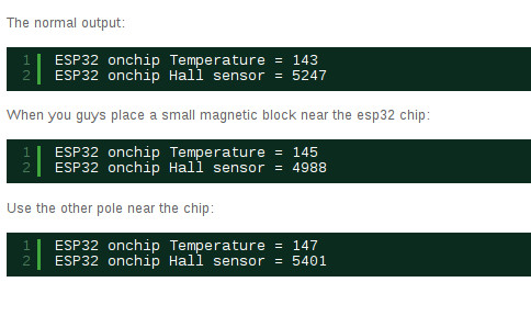

Play the onchip Hall sensor and temperature sensor
Postby comcat » Tue Nov 15, 2016 7:21 am
#include <stdio.h>
#include <stdlib.h>
#include "freertos/task.h"
#include "esp_system.h"
#include "nvs_flash.h"
uint8_t temprature_sens_read();
uint32_t hall_sens_read();
void read_sens_task(void *pvParameters)
    while (1) {
        printf("ESP32 onchip Temperature = %d\n", temprature_sens_read());
        printf("ESP32 onchip Hall sensor = %d\n", hall_sens_read());
        vTaskDelay(4000 / portTICK_PERIOD_MS);
void app_main()
    nvs_flash_init();
    system_init();
    printf("Welcome to Noduino Quantum\r\n");
    printf("Try to read the sensors inside the ESP32 chip ... \r\n");
    xTaskCreatePinnedToCore(&read_sens_task, "read_sens_task", 1024, NULL, 5,
                NULL, 0);

I found your wiki today, and were playing around with the sensors, before I found your post here.
(see http://www.esp32.com/viewtopic.php?f=13&p=2064#p2064).
The hall sensor on my board (Sparkfun ESP32 Thing) seems to be fairly insensitive. I placed a really strong magnet on the chip, but the value barely changes. Also, it drifts over time, so I can't use a fixed threshold for detecting the presence of the magnet.
I assume that there's some sort of calibration and temperature/drift compensation mechanism necessary.
Anyway, nice find.

Yes my magnet crashed the system before causing much of a change in reading. I don't know if it is due to amplification settings, ground plane, etc.. Not sure if it can be used as reed switch application. There was mention of current sensor application which would require specific layout. Waiting for official info.

1. Try the Neodymium magnet, seems like: https://www.aliexpress.com/item/Wholesa ... 02112.html
