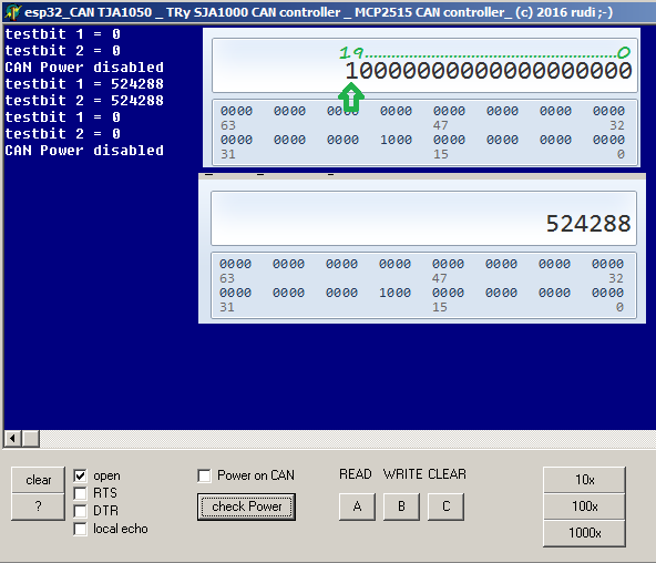

rudi ;-) wrote:
second:
not sure,
we use the same BIT in same Register for two difference function?
or have we difference Register?
Can you point me to the Register Docu / MUX `?
Or small bug?
https://github.com/espressif/esp-idf/bl ... reg.h#L940
#define DPORT_CAN_CLK_EN   (BIT(19))
https://github.com/espressif/esp-idf/bl ... reg.h#L974
#define DPORT_CAN_RST      (BIT(19))

read_pwr
uint32_t can_pwr_read (void) {
	// WHICH BIT IDX ?
	// here a simple code
	// get later more prof..
	// to do: better named
	uint32_t testbit1 = 0;
	uint32_t testbit2 = 0;
	testbit1 = GET_PERI_REG_MASK(DPORT_PERIP_CLK_EN_REG, DPORT_CAN_CLK_EN)  ;
	printf("testbit 1 CAN_CLK_EN = %d\r\n", testbit1);
	reg_delay();
	testbit2 =  GET_PERI_REG_MASK(DPORT_PERIP_RST_EN_REG, DPORT_CAN_RST)  ;
	printf("testbit 2 CAN_RST    = %d\r\n", testbit2);
	// to do:
	// better named
	return testbit1 + testbit2;

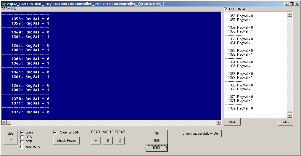

short test
Video result:
Video : ESP32 Rev 0 CAN -PART TWO- 21 Nov 2016 - unofficially custom code -

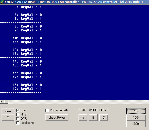

no no - comcat - there is only simple step by step base and with willful mistake
example see the note about reg_delay();
void writeRegister (void) {
    // PID 2 3 4 5 6 7
   // BIT 0 1 2 3 4 5
   // DPORT_AHBLITE_MPU_TABLE_X_REG bit
   // to do: BIT MASK FOR MPU_TABLE_CAN_REG
   // here simple for TEST BIT ( 3 )
   SET_PERI_REG_MASK(DPORT_AHBLITE_MPU_TABLE_CAN_REG, 3);
   // for tesing here is no     reg_delay();

and perhabs because this was not done, we get mistake in the response / Write to register
but this is what jeroen suggest to do that we do a small delay by
__asm__ __volatile__("nop;nop;nop;nop;nop;nop;nop;nop;");
here is example the mistake: 100x ( read, set, read, clear )
( video 2:10 to 2:15 )
missing the clear doing ( its a write! ) , perhabs cause we have not delay here:
in the next part of code ( asap ) we do testing the delay and other checkings that we get nice results without mistakes.

btw here a fine log no mistake any more in quickly write/clear - ;-)
testbit 1 CAN_CLK_EN = 0
testbit 2 CAN_RST    = 0
CAN Power : disabled
testbit 1 CAN_CLK_EN = 524288
testbit 2 CAN_RST    = 524288
CAN Power : enabled
       0: RegVal = 0
       1: RegVal = 1
