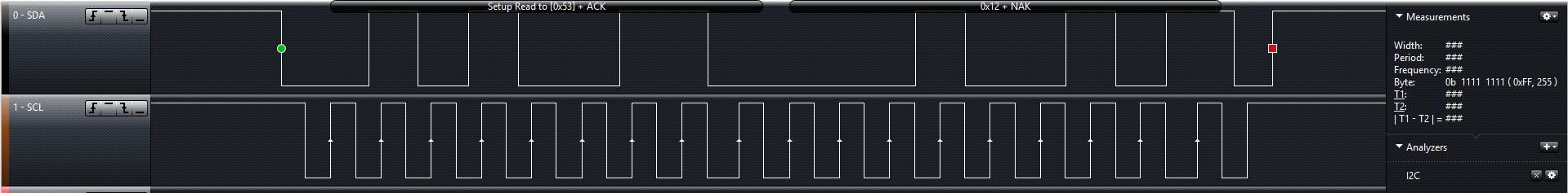

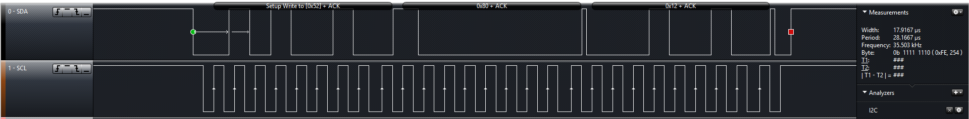

I want to read the device id from a TCS34725 but it returns the last byte written in the communiation. (In this case TCS34725_ID.)
I am using this code:

And here are the write and read result from the logic analyzer:
Any help is appreciated!
