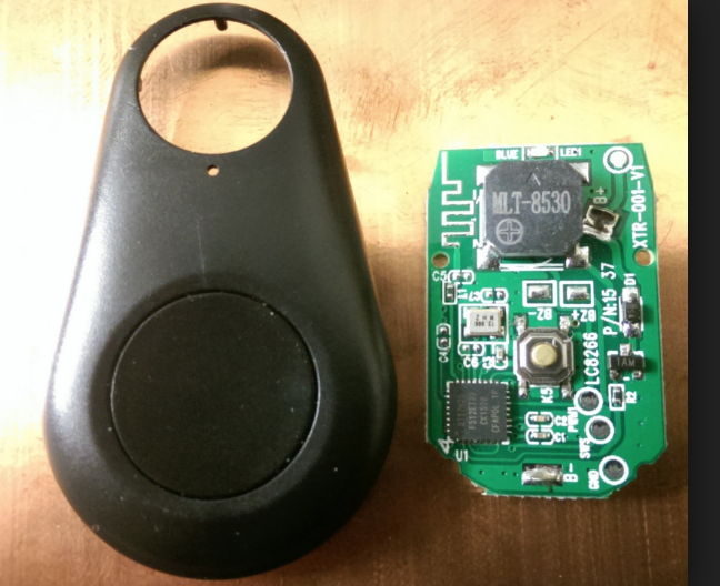

Hello, I am using gatt client example for reading the battery level value from an Itag, which is a BLE device.
The device is:
Screen Shot 2018-05-04 at 15.17.28.png (558.12 KiB) Viewed 8644 times

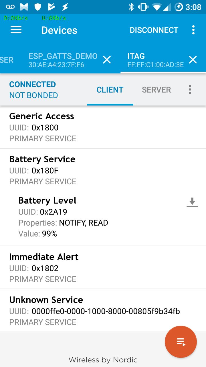

I am using the nRF Connect to discover the services advertised by the iTag. As you can see, the battery service is reporting 99%
WhatsApp Image 2018-05-04 at 3.08.24 PM.jpeg (82.73 KiB) Viewed 8644 times
I have modified the gatt client code to read the service UUID from the itag.
#define REMOTE_SERVICE_UUID        0x180F //iTAG battery service
#define REMOTE_NOTIFY_CHAR_UUID    0x2A19 //battery level characteristic
I found that when the esp_ble_gattc_register_for_notify funcion is called, it return 0 (cero) descriptor for the characteristic. Instead of calling for esp_ble_gattc_register_for_notify, I call instead esp_ble_gattc_read_char.

I (1774) GATTC_DEMO: ESP_GATTC_READ_CHAR_EVT
I (1774) GATTC_DEMO: p_data->read.value c
I (1774) GATTC_DEMO: p_data->read.value_len 1
I am confused because I think it should return "99%", am I correct?
