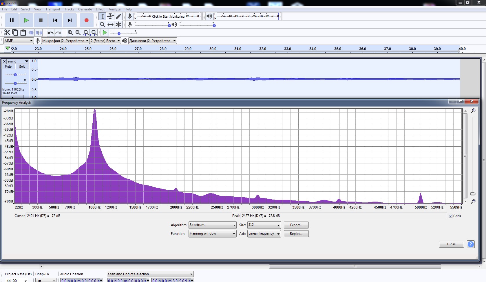

I'm trying to get data from this PDM microphone:
https://www.invensense.com/wp-content/u ... 0-v1.1.pdf
Here is my initialization:
void i2s_init()
	 int i2s_num = 0;
	 i2s_config_t i2s_config = {
        .mode = I2S_MODE_MASTER | I2S_MODE_RX |I2S_MODE_PDM,
        .sample_rate =  48000,
        .bits_per_sample = 16,
	    .communication_format = I2S_COMM_FORMAT_PCM,
	    .channel_format = I2S_CHANNEL_FMT_ONLY_RIGHT,
	    .intr_alloc_flags = 0,
	    .dma_buf_count = 2,
	    .dma_buf_len = 1024
	 i2s_pin_config_t pin_config = {
	    .ws_io_num   = PIN_CLK,
	    .data_in_num = PIN_DATA,
	 //install and start i2s driver
	 i2s_driver_install(i2s_num, &i2s_config, 0, NULL);
	 i2s_set_pin(I2S_NUM_0, &pin_config);

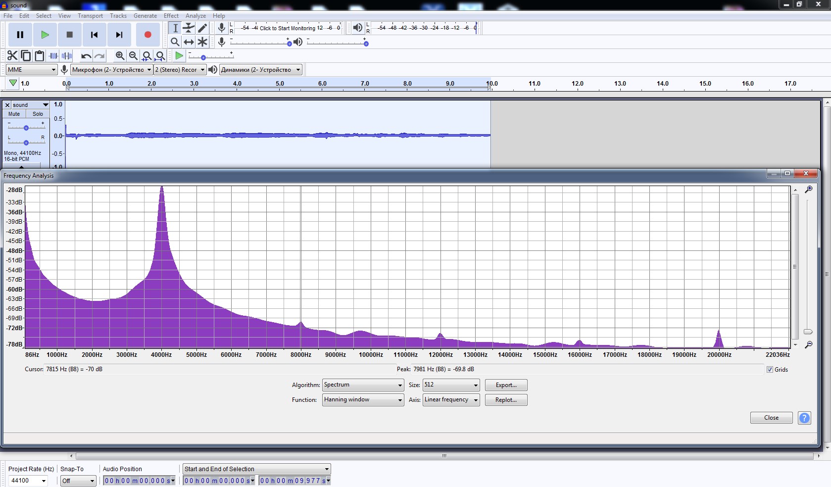

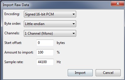

I'm not sure how to read data from PDM format, I have tried with function below, but output looks is pretty gibberish ( a lot of repeating bytes...)
#define READ_LEN (2 * 1024)
uint8_t BUFFER[READ_LEN] = {0};
void ICS41350_disp_buf(uint8_t* buf, int length)
    printf("======\n");
    for (int i = 0; i < length; i++) {
        printf("%02x ", buf[i]);
        if ((i + 1) % 8 == 0) {
            printf("\n");
    printf("======\n");
void ICS41350_record_task (void* arg)
    while (1)
	    i2s_read_bytes(I2S_NUM_0, (char*) BUFFER, READ_LEN, (1000 / portTICK_RATE_MS));
	    ICS41350_disp_buf((uint8_t*) BUFFER, READ_LEN);
	    vTaskDelay(1000 / portTICK_RATE_MS);
void app_main()
    i2s_init();
    xTaskCreate(ICS41350_record_task, "ICS41350_record_task", 1024 * 2, NULL, 5, NULL);
And here is log:

Now problem is how to handle data properly with software: I have recorded 1kHZ tone from mobile phone speaker.
When I'm trying to replay it, I sounds like speeded up x4 times.
Here is output on sampling with this settings:
import settings
44.1kHz spectrum
But if I change sampling ratio to 11025Hz, I got correct sound spectrum with main peak at 1kHz:
11025 Hz spectrum
