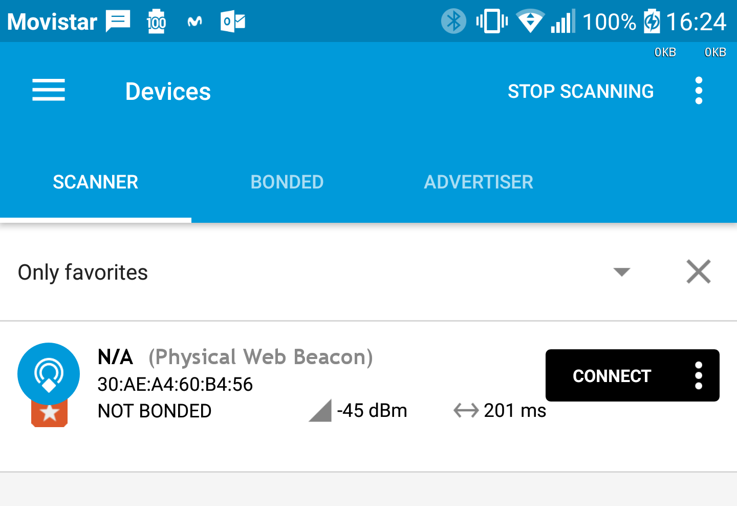

Hello everyone, I'm having an issue when setting a Beacon with both advertising packet and scan response.
Here is my code.

Here you can see the advertising interval parameters with minimum and maximum values I found in one example. 32 would be 20ms.
// data advertising parameters.
// TODO error with min. and max
static esp_ble_adv_params_t ble_adv_params = {
		.adv_int_min = 32,
		.adv_int_max = 32,
		.adv_type = ADV_TYPE_NONCONN_IND,
		.own_addr_type  = BLE_ADDR_TYPE_PUBLIC,
		.channel_map = ADV_CHNL_ALL,
		.adv_filter_policy  = ADV_FILTER_ALLOW_SCAN_ANY_CON_ANY,

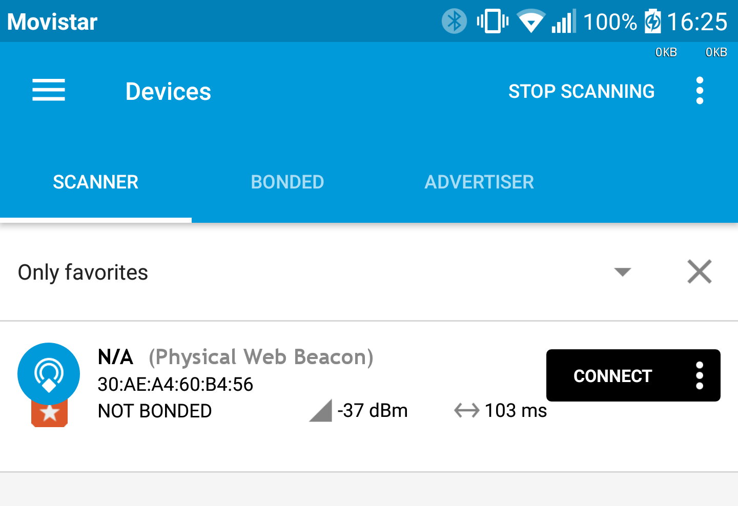

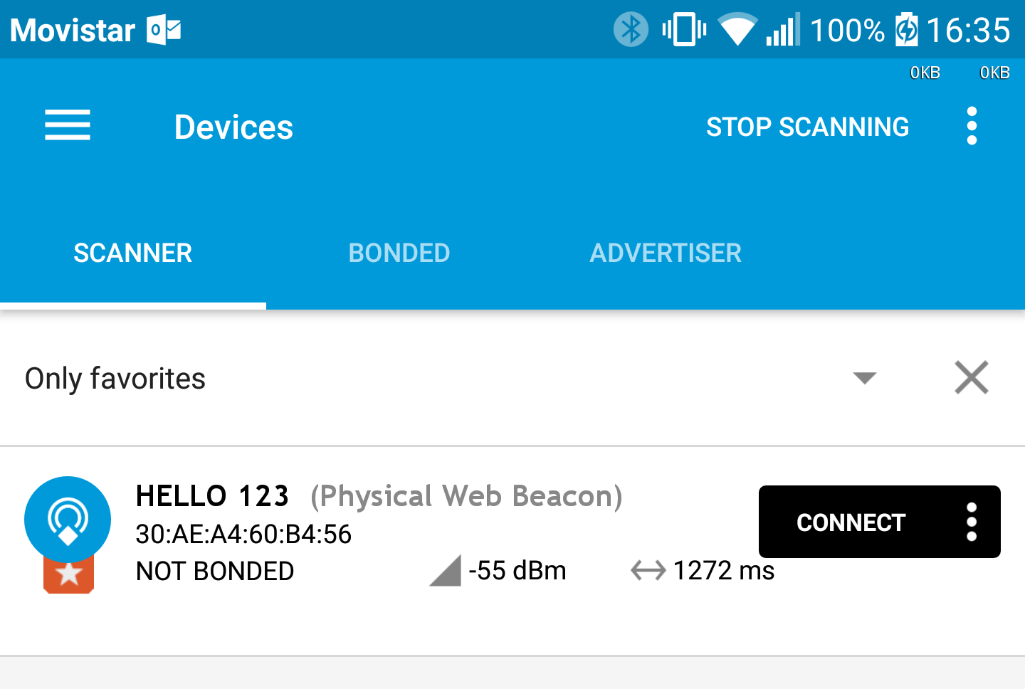

and here is the output in NRF Connect.
As you can see, the advertising interval is wrong (not 20ms, which I clarify I'm not using) because is the default interval provided by ble_gap_api.h which is 1,2 seconds.

Unfortunately, this setting is the only way for advertising packet an scan response packet to coexist. Setting the interval to any value different from 20ms breaks the scan response functionality.
Now, the 1.2 second interval is not appropriate for advertising because only powerfull devices would catch the information. Looking for advertising normative in Apple iBeacon (https://developer.apple.com/ibeacon/) shows an appropriate value of 100ms for stability, and Goggle Eddystone says 200ms for a little more power-efficiency.
min 160, max 160 (100ms)
min 320, max 320 (200ms)
I appreciate any help you can provide me. feel free to ask any question.
