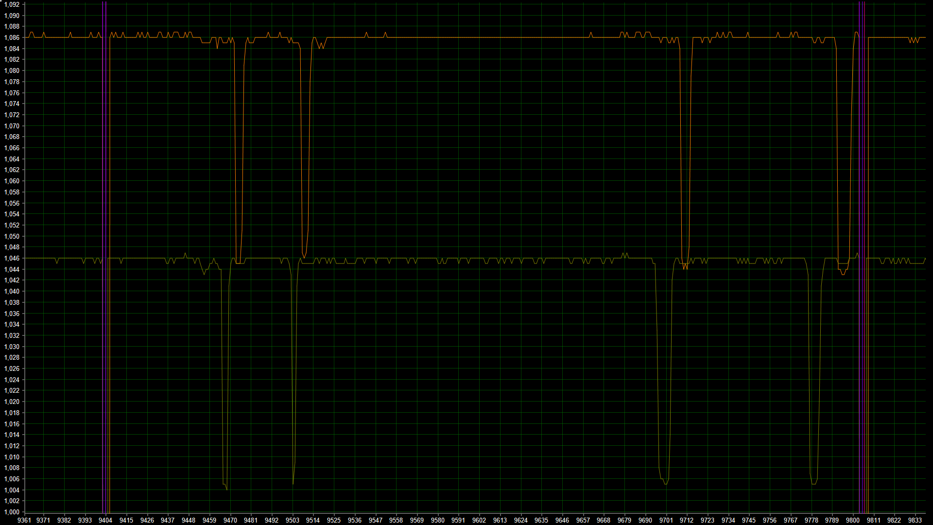

Alfred
Joined: Tue Jul 03, 2018 12:42 pm
Re: Touch sensors are a little less sensitive in the first 30s after wake from sleep
Postby Alfred » Tue Jul 03, 2018 1:03 pm
I have test your case, the result seems normal. Please check the picture. The change of the touch is the same, within 60 seconds of sleep waking up.
- Please provide the version of idf you used.
- Please use only the sleep and touch function tests.
- or, Provide test code.
dave111
Posts: 45
Joined: Fri Mar 03, 2017 1:37 am
Postby dave111 » Sat Jul 07, 2018 4:02 pm
I was using v3.0-rc1 from 2018 Feb 21. I have now upgraded to v3.0.1 and this appears to fix the "less sensitive in the first 30s after wake" issue. I am not seeing this behavior anymore. This is great.
However, while in deep sleep, sensitivity does still appear to be slightly lower than at runtime after calibration. With the 2mm panel on top, slightly touching a sensor will not (always) wake the device. However, once it is awake and the touch_pad_config() values have been restored from flash (aka RTC_DATA_ATTR), touching the sensors in the exact same way does trigger an event every time. It definitely feels more sensitive. Are you sure the sensors use the last touch_pad_config() data while in deep sleep? Because I definitely have to restore them post deep sleep.
And one other thing I noticed: I have also tried upgrading to v3.1-beta1. But here, if any sensor is touched at runtime, xEventGroupWaitBits() does always return 0x3FD (decimal 1021; could this be an error code?). In other words: no matter what sensor is being touched, all touch sensors will report back. I do not see this when I switch my unmodified code back to IDF v3.0.1.
