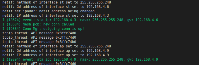

I am running with wifi initialised in APSTA mode currently.
What I'm trying to do is setup the station and softAP interface with different IP addresses in different subnets when the Station has connected to an AP.
So what happens is the Station connects to its network, then the AP is reconfigured with an IP address in a different subnet.
However, when I configure the AP after the Station connects the Station's IP addresses are changed to what the AP is configured with.
Screenshot from 2018-07-11 12-30-15.png (43.3 KiB) Viewed 6476 times
The image shows the gist of what I'm talking about from the terminal. The Station gets its DHCP assigned address, then the AP's is changed, but the event comes back syaing the sta ip is changed...
My code to change the AP IP stops the DHCP server, makes the change and re enables.

Okay, so I've been digging into the tcpip_adapter source. This is the set_ip_info function I'm calling
esp_err_t tcpip_adapter_set_ip_info(tcpip_adapter_if_t tcpip_if, tcpip_adapter_ip_info_t *ip_info)
    struct netif *p_netif;
    tcpip_adapter_dhcp_status_t status;
    TCPIP_ADAPTER_IPC_CALL(tcpip_if, 0, ip_info, 0, tcpip_adapter_set_ip_info_api);
    if (tcpip_if >= TCPIP_ADAPTER_IF_MAX || ip_info == NULL) {
        return ESP_ERR_TCPIP_ADAPTER_INVALID_PARAMS;
    if (tcpip_if == TCPIP_ADAPTER_IF_AP) {
        tcpip_adapter_dhcps_get_status(tcpip_if, &status);
        if (status != TCPIP_ADAPTER_DHCP_STOPPED) {
            return ESP_ERR_TCPIP_ADAPTER_DHCP_NOT_STOPPED;
    } else if (tcpip_if == TCPIP_ADAPTER_IF_STA || tcpip_if == TCPIP_ADAPTER_IF_ETH ) {
        tcpip_adapter_dhcpc_get_status(tcpip_if, &status);
#if LWIP_DNS /* don't build if not configured for use in lwipopts.h */
        dns_clear_servers(true);
#endif
    ip4_addr_copy(esp_ip[tcpip_if].ip, ip_info->ip);
    ip4_addr_copy(esp_ip[tcpip_if].gw, ip_info->gw);
    ip4_addr_copy(esp_ip[tcpip_if].netmask, ip_info->netmask);
    p_netif = esp_netif[tcpip_if];
    if (p_netif != NULL && netif_is_up(p_netif)) {
        netif_set_addr(p_netif, &ip_info->ip, &ip_info->netmask, &ip_info->gw);
        if (!(ip4_addr_isany_val(ip_info->ip) || ip4_addr_isany_val(ip_info->netmask) || ip4_addr_isany_val(ip_info->gw))) {
            system_event_t evt;
            evt.event_id = SYSTEM_EVENT_STA_GOT_IP;
            evt.event_info.got_ip.ip_changed = false;
            if (memcmp(ip_info, &esp_ip_old[tcpip_if], sizeof(tcpip_adapter_ip_info_t))) {
                evt.event_info.got_ip.ip_changed = true;
            memcpy(&evt.event_info.got_ip.ip_info, ip_info, sizeof(tcpip_adapter_ip_info_t));
            memcpy(&esp_ip_old[tcpip_if], ip_info, sizeof(tcpip_adapter_ip_info_t));
            esp_event_send(&evt);
            ESP_LOGD(TAG, "if%d tcpip adapter set static ip: ip changed=%d", tcpip_if, evt.event_info.got_ip.ip_changed);
    return ESP_OK;
The way I read this, it looks like a SYSTEM_EVENT_STA_GOT_IP is triggered whenever this function is called regardless of the interface being operated on.
To me this is wrong if the event is "STA_GOT_IP" and you call the function with TCP_ADAPTER_IF_AP.
Am I misinterpreting this?

Seems you are correct.
