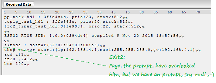

after boot the screen is "empty" ( no prompt ) :
EDIT2 we have a prompt, see picture at end
ht20 , 2412\r\n
bcn 100\r\n
ok. btw perhabs missed the prompt at start?

REMIND SCREEN STAND: :>
USER INPUT again: ram\r\n
SCREEN OUTPUT NOW:
ram\r\n
\r\n
free heap size:0x12024 73764\r\n
\r\n
:>what?\r\n
