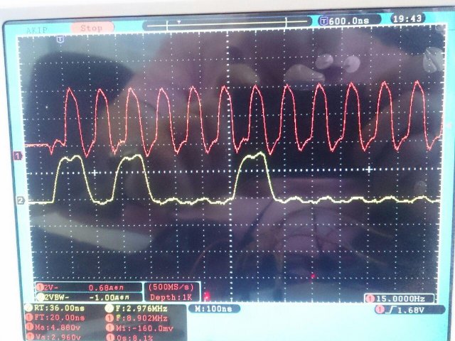

My result:
in case use HSPI & VSPI mapped like this:
HSPI_CLK = 14 or 25 GPIO
HSPI_MOSI = 13 or 26 GPIO
HSPI_MISO = 12 or 32 GPIO
HSPI_CS = 15 or 33 GPIO
VSPI_CLK = 18 or 21 GPIO
VSPI_MOSI = 23 or 22 GPIO
VSPI_MISO = 19 or 19 GPIO
VSPI_CS = 05 or 23 GPIO
the maximum speed of CLK is 9 MHz. However, when I use VSPI at CLK = 26MHz - it work correctly.
I connected ESP32 + 2xMAX3421E and try blik led, whic connected to MAX3421E's GPIO

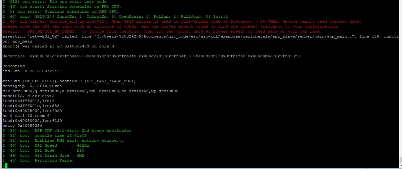

I am having the same issue, but probably has to do with the CPU frequency. I can measure SPI at maximum 26 MHz. When I set it at 40, my scope doesn't show any signals. How can I change the CPU frequency higher? Is the function included in one of the examples?

Re: SPI Maximum speed
I am using ESP-WROOM-32D module on the devkitc. I see that the module has a 40 MHz crystal.
Then how can I verify what you say about the internal bus clock? Where is that located? Isn't that derived from the CPU's clock as well?

Actually, I said a bit of bullsh*t above. The APB_CLK the SPI periferial is using is actually derived from the CPU clock.anakyr wrote:I am using ESP-WROOM-32D module on the devkitc. I see that the module has a 40 MHz crystal.
(Technical reference manual, top of page 40).
APB_CLK is 80MHz, and SPI max clock is APBfreq/2, so 40MHz, with all other deviders set to default state.
Are you 100% sure that you in fact have a 26MHz clock on the module?
By default in Menuconfig you select 40MHz clock, which tells the rest of IDF that you run a 40MHz CPU, which will use it in it's calculations as reference, even though you may be having a different clock!
By setting 40MHz, it means - i guess - that almost all the clock deivders are set to their default state - eg. no clock devision - so it should be 40MHz coming out. Having no devision and 26MHz coming out suggest to me that in fact you have a 26MHz crystal on your module.
Maybe I'm wrong, but it's woth trying to work with clock register settings. (TRM Page 132 SPI_CLOCK_REG)
You can also try to use the formula on Page 121, to calculate the register values needed for 26MHz clock, and then read out the registers, to see if register settings are the same as you calculated.

I'm 100% sure that I have a 40MHz crystal. Check attachment too. I will try first to include SPI_DEVICE_NO_DUMMY in order to ignore this checking, as the error message in red is saying. If it doesn't work, I will go to the registers
