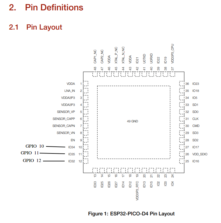

May be more friendly name of GPIO?
"pad 10" == "IO34"
Or if we look the documentation https://www.espressif.com/sites/default ... eet_en.pdf
page 9
"IO 15" == "pad 21" == "RTC_GPIO 13" .... wtf???
why "pad 21" != "IO 15" != "RTC_GPIO13"?
Not bad if it is possible to realize hardware USB with a lot of EP
Not bad if it is possible to realize 2 ULPI interface
Wi-Fi 5GHz + WPA3
I mean at current version of ESP32/ESP32-PICO-D4"pad 10" == "IO34"
page 9
Wi-Fi 5GHz + WPA3

Re: What would you like to see in The Next Chip?
I get your gripe with the GPIOs. While we will not have direct GPIO <-> pad mappings (because it means we'd only be able to make one form factor chip - using the same silicon between e.g. the Pico and the 'bare' ESP32 chip would be impossible without messing up the pad numbering), we do get the weirdness of the RTC GPIO mapping and we will fix this in a future chip. Hardware USB will be possible (how much EPs did you have in mind, by the way, and did you have a specific purpose in mind?) but no ULPI support is planned for the immediate next chip. (Repetition of the disclaimer I stated a few times through this topic: these are estimations, and our roadmap may change in unexpected ways because of unexpected circumstances, no guarantees implied in any statements here.) Similarily, the immediate next chip will not have 5GHz, but we do have fairly advanced plans for a 5G chip. WPA3 is a software thing (mostly) and we may implement this even for the ESP32.
