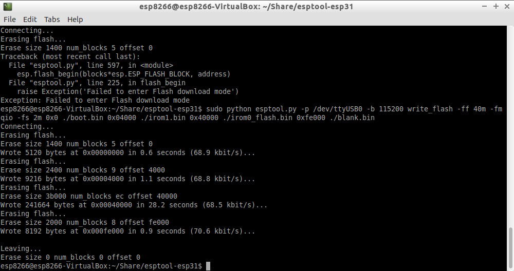

Hi
short and dirty: Done!
First test, read_mac with esptool.py and esptool32.py ok
btw, esptool do not support 1MB
then flasing: and dear espressif if you have test my first user compile firmware
then you know the message
Dear espressif XXX-Mas Christmas! Thanks a lot for the SDK & ESP32!

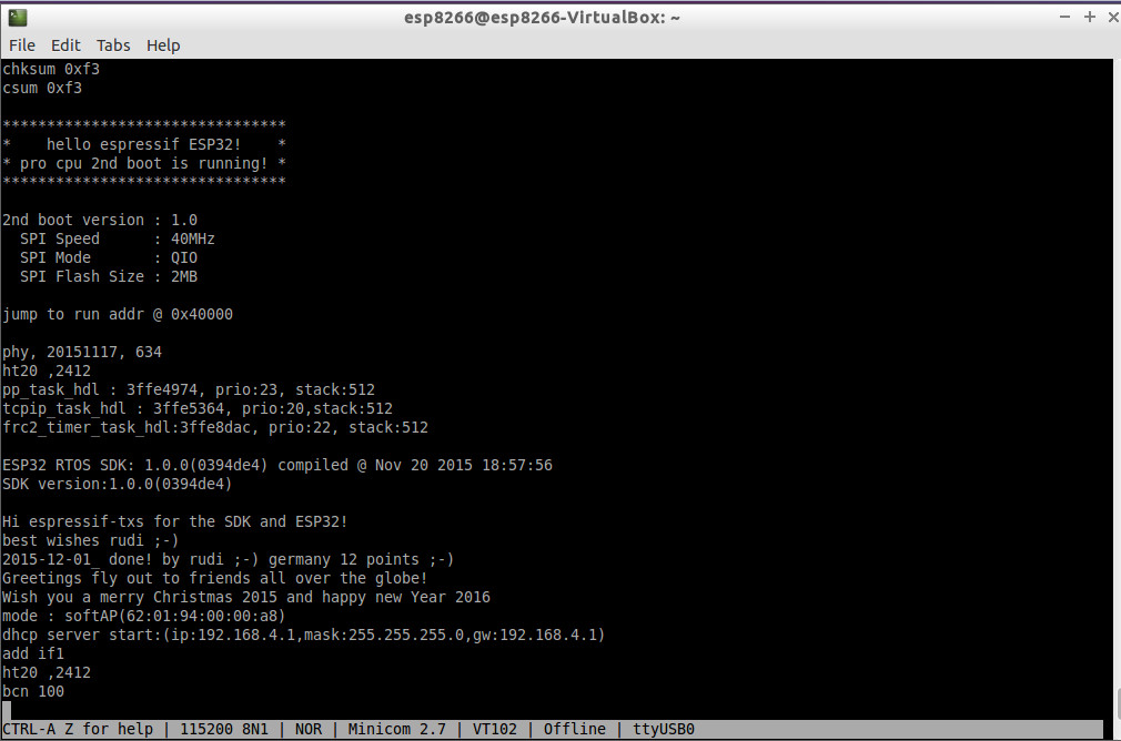

Well compile, well booting: but think, the board need a little warm air - have hot air 260°Celsius arround clock ( oszillator) and c1 and c2, will check next time in detail again, what the reason was.
a finger touch sense and this pump.
my rigol is ready for start too, i must hot air before start with modul, then bootloader and app code ok. without, there is no start possible. perhabs a toggle contact, or tempsensor?
@Jeroen, think there is a cold fussion. have fluxed and then reset comes alone,
then hot air 260 °Celsius short and can switch fine. this hot air i must do allways.
will check next time whats up here.

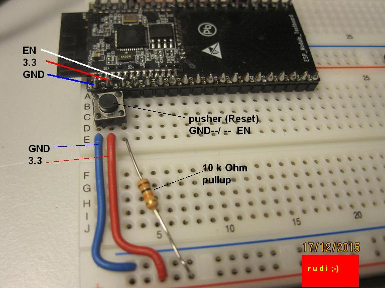

btw: have make a switch like this now for better test:
EDIT: The name "Reset" is not the right choiced functional word,
better ( push_the_button_and_release_it ) "Power Off/PowerOn to Chip_Enable"

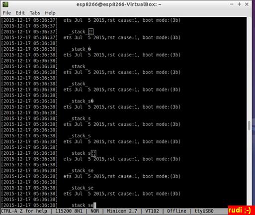

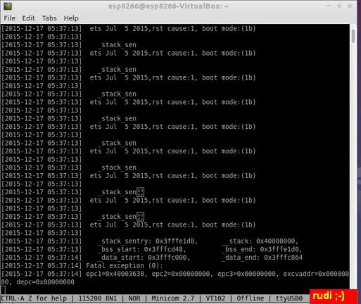

Re: Flash Tool
Hi
Are there info about boot mode 1b (upload mode ) and 3b (bootprocess) ?
what the bootloader wait for at 1b? most time then exception : epc1=0x400003638, other 0x0.. whats up
just in time i am in 1b if i go to upload mode (GPIO0 low) and 3b if i go to "start SPI flash" (GPIO0 high). have play a little with pins. think we have more tactics to go in boot options
now, if someone know, how i come out from 1b

what options we have in 1b and 3b?
what are 1b and 3b?
sometimes in 1b exception : epc1=0x400003638, other 0x0.
