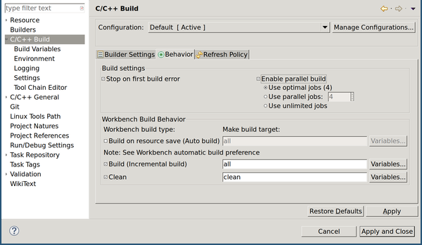

I would like to improve the time of the compilation.
It is very slowly and it makes imposible to work with ESP32.
I am reading some threads about it and I think that it could be very good issue:
Run the build with "make -jN" where N is a large-ish number (try double the number of CPUs in your system).
but where I must to put this line?

How are you building ESP-IDF now? By running "make", or by using Eclipse or some other program?

Re: The compilation is very slowly
I am using eclipse framework.
You can enable parallel builds (equivalent of -j option) in the Project Properties under C/C++ Build -> Behavior:
You may find you get even better performance on Windows by choosing more than the "Optimal" number of jobs.
Running parallel builds helps in Windows. However the slowness of Windows builds was a major reason for supporting CMake in IDF V3.2 (and migrating to CMake by default in IDF v4.0.) Building under CMake is still faster in Linux, but the difference is significantly less...
(When we were first previewing CMake, a full CMake+ninja build under Windows was approximately as fast as a GNU Make build under Linux, but a full CMake+ninja build under Linux was faster than a GNU Make build under Linux... I haven't re-benchmarked since the CMake support became more mature.)

Will add this to the Eclipse Setup guide.You may find you get even better performance on Windows by choosing more than the "Optimal" number of jobs.
Currently Linux is significantly faster, to the extent that running Linux in a VM on a Windows host is significantly faster than building on the host.Has anyone done a performance test of a build on Linux compared to a build on Windows 10 for the same application/project?
Disabling Windows Defender entirely is an option if you don't mind disabling all spyware protection... A number of people have reported success by adding their MSYS32 directory (and any directory containing IDF files) to an "ignore" list for Windows Defender and/or other anti-virus programs.1. Regedit
I have Win 10 Defender set to ignore my development directory. Because a build creates so many files it gets Defender really chugging if you don't. I've been developing for the last 8 months in windows using the -j8 (8 = number of threads in CPU, or 2 x # of cores), and I haven't found it to be so slow as to be a problem. I normally develop with a Win 7 computer, but my newest laptop has 10 and I use it for work occasionally.
