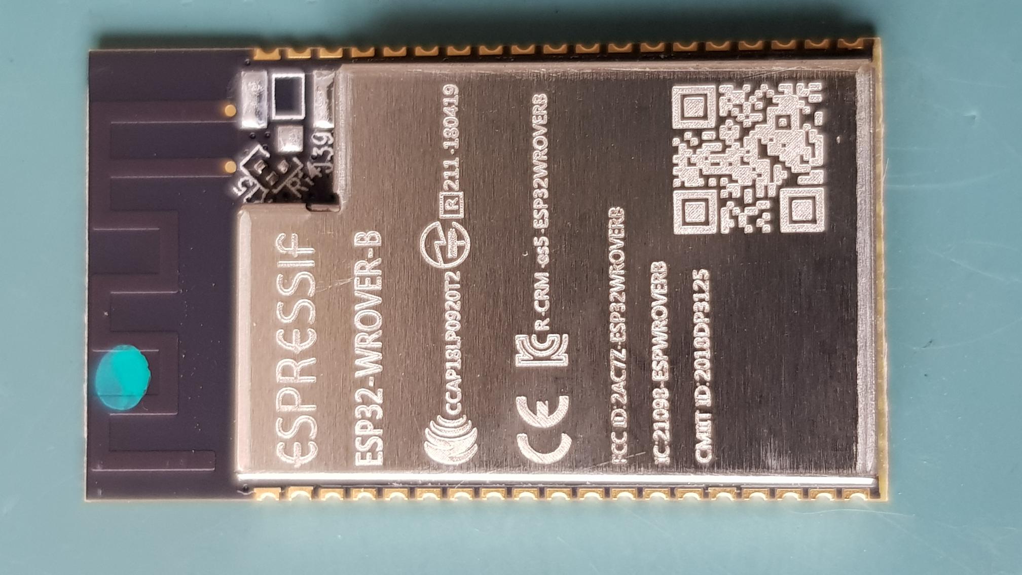

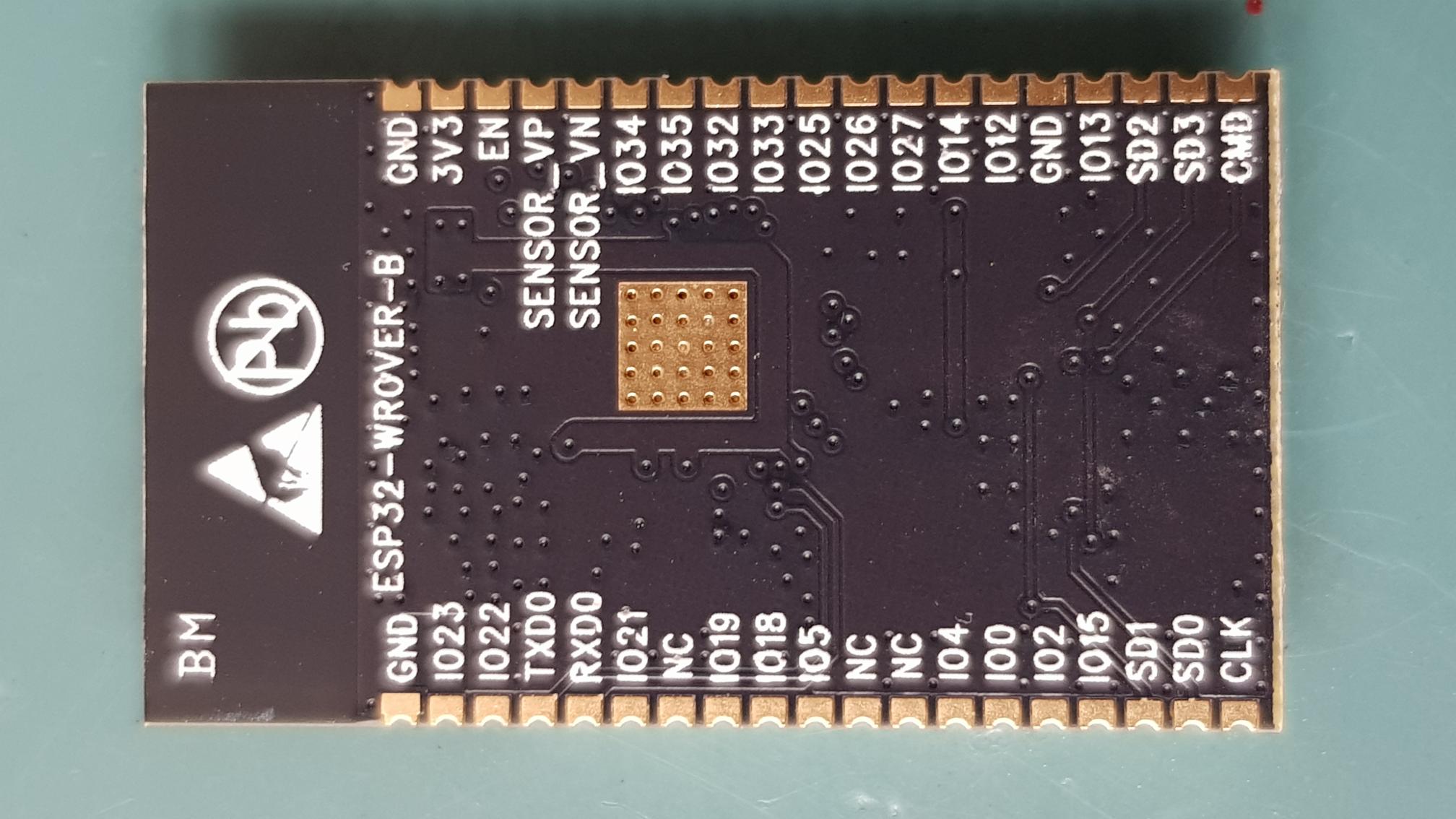

Well first wrover-b is labeled on shield so you should be able to identify it 100%.
Board1 has adc 2-point cal with 3/4 coding
Board 2 has adc vref with no coding

Manufacturing confirms that apart from some engineering samples (not offered for sale), no ESP-WROVER-B modules were produced with 3/4 Coding Scheme.
snahmad75, I'm not sure how your distributor is showing you a ESP-WROVER-B module with CODING_SCHEME efuse value 1 (3/4 Coding Scheme). Maybe the modules got mixed up?

The WROVER-B modules which we have from our distributor (Mouser) - actual photos:

Reading out the e-fuses on these wrover-b shows CODING_SCHEME = 1....FLASH_CRYPT_CNT Flash encryption mode counter = 0 R/W (0x0)

Yikes! Well there definitely needs to be fully documented and supported 3/4 coding scheme ASAP then.
Hopefully @ESP_Angus can answer: why does BLK3_PART_RESERVE auto select 3/4? How does the encryption engine handle the 192bit key? Will all 2 point Cal modules ship with this configuration? Is this an isolated batch and what are the dates/Mac ranges? how can we know when buying from a distributor what config we are getting (vref vs 2 pt)?
Re: encryption is working on one device not other
Hi Grant,
Apologies, it seems manufacturing team gave me wrong info. They're re-checking the production batches where the coding scheme was changed. Will update ASAP.
Support for 3/4 Coding Scheme is in review now, and should be merged to master branch next week.
It will be released as part of ESP-IDF V3.1.2, planned for November.
Newer modules have neither of these things, but they all have VRef calibration.
There's no technical reason for this. The two changes are unrelated apart from the fact they were applied at the same time, and have been removed at the same time.WiFive wrote: why does BLK3_PART_RESERVE auto select 3/4?
The hardware algorithm is always AES-256. With 3/4 coding scheme, the key is extended (bits 64-127 are repeated) in order to make a 256 bit key. Full details are in the change which is currently being reviewed.WiFive wrote:How does the encryption engine handle the 192bit key?
Currently all modules with 2 point calibration have BLK3_PART_RESERVE=1 and CODING_SCHEME=1 both set, yes.WiFive wrote:Will all 2 point Cal modules ship with this configuration?
As mentioned above, there'll be a statement on this soon.WiFive wrote:Is this an isolated batch and what are the dates/Mac ranges? how can we know when buying from a distributor what config we are getting (vref vs 2 pt)?
