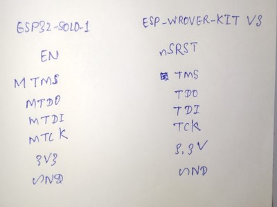

I am unable to program ESP32-SOLO-1 using JTAG on the ESP-WROVER-KIT v3.
JTAG Connections:-
also, I enabled single core mode in menuconfig.
openocd output:-
$ ~/esp/openocd-esp32/bin/openocd -s ~/esp/openocd-esp32/share/openocd/scripts -f interface/ftdi/esp32_devkitj_v1.cfg -f board/esp-wroom-32.cfg -c "program_esp32 build/hello-world.bin 0x10000 verify exit"

Fwiw: 'Error: JTAG scan chain interrogation failed: all ones' usually means there's something wrong on a very low level: the JTAG adapter physically cannot talk to the JTAG hardware. Are you sure the SOLO-1 does not have a program in it that reconfigures the JTAG pins for something else?

This is a fresh module and first time programming it.
can you give us proper connection details and configurations for this module?

My esp-solo module was faulty. I tried with another solo module, was able to flash program using serial bootloader but when trying with JTAG, I am getting this message:-
