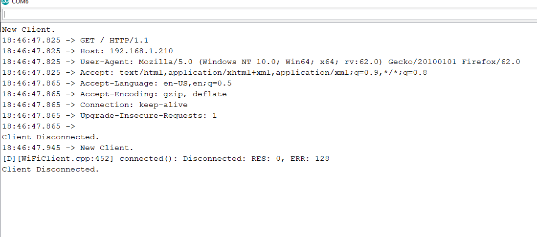

I faced with strange problem - in old ver of libs HTTP server answer to browser very fast (about 20 request in sec). But with new libs (esptool 2.3.1 xtensa 5.2.0) basic example SimpleWiFiServer.ino answer and freze for some timeout. It seemed that client.stop() not kill connection and client.avalable() == true and program spin in while() cycle to timeout...

Terminal showes one call from firefox and timings:
serial output

It seemed that the reason in WiFiClient.cpp code. Old version code different and work well (have no "*RxBuffer" instances).

It seemed that wifi goto in sleep mode. I disable sleep mode after Wifi.begin() and all work fine!
void setup()
WiFi.begin(ssid, password);
WiFi.setSleep(false);// this code solves my problem
