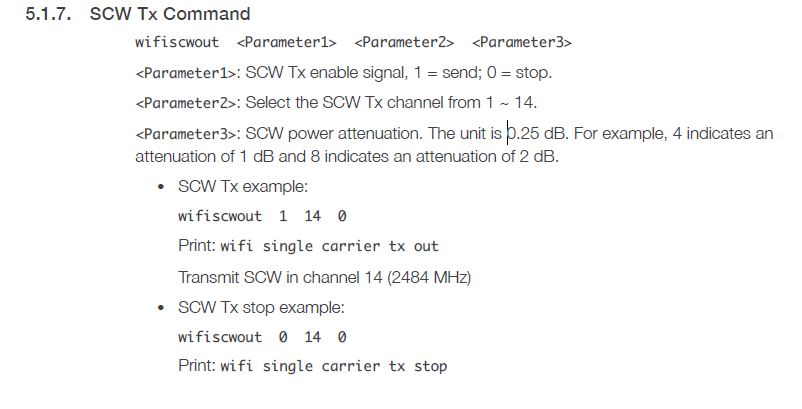

I have tested the radiated power of an esp-wroom-32 module using the wifiscwout command and I found problems with parameter 3.
What I understand from the documentation is that when parameter 3 is 0, I should have the highest power and then for every single unit attenuation increases 0.25dB.
Up to parameter3=40 this is true but after 40 this pattern changes.
I managed to get a highest power value using parameter3=236. But when I use other values between 40-255, as parameter3 is an 8bit number, the result is always unexpected and I cannot find a pattern. What is happening?
