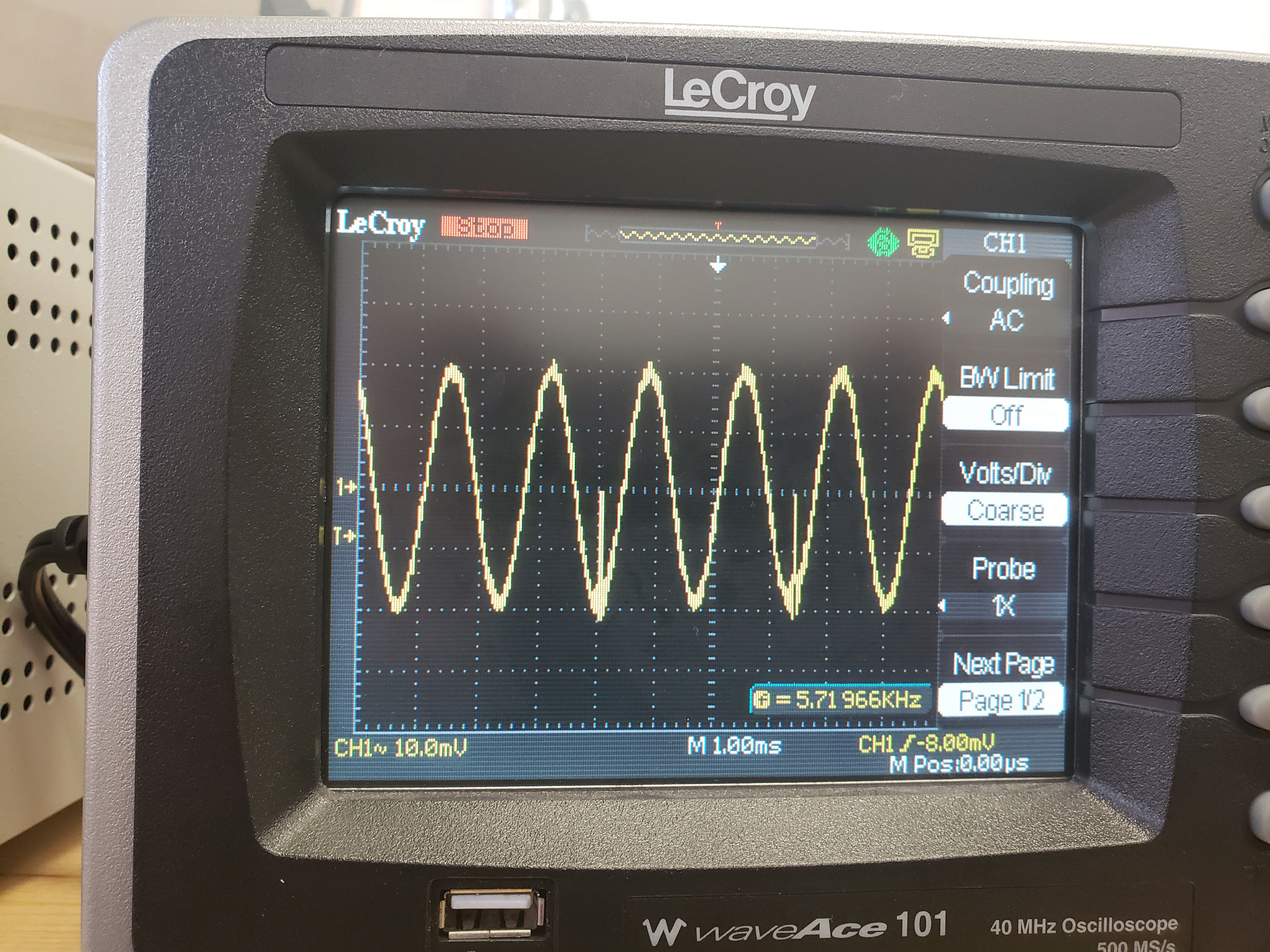

I've been fighting an I2S problem for about two weeks, and I've finally broken down and decided to ask for help.
Here's the issue:
1) I2S received from my CODEC (NAU8822) is perfect and clean.
2) I2S sent to my CODEC has enough bad transfers to make it sound "crackly," like playing a dusty record.
Some waveforms
This is an o-scope capture. This wave was generated by using Audacity to create a tone. The tone was then exported as raw PCM data, saved to an SD card, then opened, copied to an array, and then written to I2S. Notice the fairly random ticks. In this case, they're all zeroes, but that's not always true.
This is a screen cap from Audacity. I used ESP to record an audio signal from the CODEC in I2S, then copied that buffer directly to the SD card. I then imported the data from the SD card into Audacity. Notice that it's perfectly smooth with no "hiccups."
Some Details
1) The CODEC is NAU8822, clocked externally by a high-accuracy 11.2896 MHz oscillator
2) The oscillator is divided by 256 to give a 44.1 KHz sample clock.
3) The system is configured such that the CODEC is the master of all clocks, and ESP32 is the slave.
I have done extensive testing to figure out where the source of the problem is, and I'm pretty sure that it has something to do with the ESP chip. The CODEC works great, sends clear data, and sounds crystal clear when configured in its loop-back test mode.
I have tried writing data from the SD card to the I2S port - Still noisey.
I have tried generating waveforms programmatically and writing them to the I2S port. -Still Noisey
I have tried reading data directly from the I2S port then copying it back. - Still Noisey
Here are some bits of code. Tell me if you see anything wrong here, or have any ideas.

Cloud you test with follow configuration? Change ESP32 I2S mode is master, and increase length of `dma_buf_len`.

ESP32's I2S interface has problem in slave mode. It use its internal clock to clock the state machine, when the internal clock is faster than the mclk, it will cause I2S FIFO underrun. So, you must use the codec as slave and ESP32 as master.

Thanks for your help.
First, the good news:
Changing the setup so that ESP32 is Master works for the application, so I appreciate the advice. I'm getting good data in both directions for the first time.
The bad news:
Getting this to work correctly required me to match the output from the i2s config utilities:
Code: Untitled.c Select all
I (216) I2S: PLL_D2: Req RATE: 44100, real rate: 44642.000, BITS: 16, CLKM: 14,
BCK: 8, MCLK: 11289966.924, SCLK: 1428544.000000, diva: 64, divb: 11
Since the ESP32 creates an LRCLK of 44642, I had to spend quite a lot of time tuning my PLL to the right speed, and I'm not sure if I won't have "skips" during long reads. I'll find out later. Also, this is a non-standard recording speed, so it's only useful for internal DSP stuff, and can't reasonbly be used for recording purposes, as it will run about 1.2% too fast.
A final thought:
Will we have a clean I2S Slave mode soon on the ESP32? It should be easy-ish to run it purely on interrupts, or to have it reset its internal timer after every data frame. Even at 1.2% variance, it should be able to run quite a few cycles before it starts to miss its input and output.
Thanks for you help.
-viduata

I think you should set the ".use_apll = true". Audio PLL is suitable all the sample rate.
