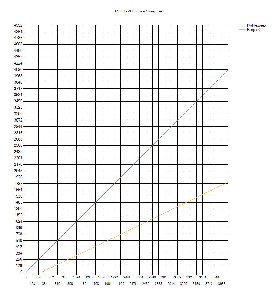

High offset levels needs fixing.
The high offset levels of the ADC makes it difficult to read lower voltages. As the ADC lowest range starts from zero at appr 70-100 mV you need external signal conditioning to lift the signal into "view".
Also noticed the ADC 12-bit, Range 3 is exremely unlinear. See image..
The light blue line is an RC filtered 12-bit 3.4V PWM to DC voltage and ADC values are averaged from 100 readings at each point.

Re: ESP32 ADC Calibration curves?
A closer look at the large ADC offsets
About the offset you can see the PWM to DC signal has the ouput at 150 ticks before the ADC Range=3 reading bcomes > 0.
A closer look:
A closer look:
To show the PWM is not unlinear a 0.5X voltage divider using 220k resistors feeding the ADC input. As seen the lower half scale in Range 3 is pretty straight.
And this is also serves as a demonstration of the 12-bit ADC used for 6.4V full scale input, where the ADC does not producing readings >0 until >0.12 volts.
Reading a linear sweep 0..3.4 V with a 0.5X voltage divider usiing 12-bit ADC, Range 3.
I don't think it helps with the lower-end dead offset between 0-70 mV, does it?
