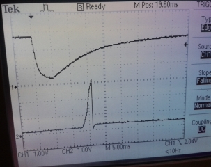

Hi. Can someone in this forum of expertise explain this ESP32 interrupt behaviour, please? I can work around the problem I have, but I obviously have something misunderstood.
[/code] I'm counting fairly slow pulses (a flashing LED which I sense with a light-dependent resistor). My input signal for one pulse is shown at the top trace.
I send some debugging information (a byte counter in range 0-255) to the DAC output on the ESP32. That's shown here on the lower trace.
I trigger an interrupt on the falling edge of my input. I get and clear the interrupt and set my ESP32 DAC level to zero.
Now as my input signal climbs slowly back through the range 1.6v to 1.9v, I get a burst of unwanted interrupts - I count them and reflect the count to the DAC. So the second trace shows the DAC output, which climbs as I get unwanted interrupts. (with modulus 256 wrapping back to zero if I get too many unwanted interrupts - the one attachment below shows about 1500 unwanted interrupts while my source pulse climbs back to its rest voltage).
I've looked at this signal at higher time resolution in case my external source is using some kind of high-frequency PWM, but I cannot find any evidence.
So what exactly does it mean to trigger a GPIO pin interrupt on a "falling edge"? How far does the voltage have to fall, and are there some kind of Schmitt trigger lower and upper bounds? Why am I apparently seeing falling-edge interrupts as my source signal is climbing?
I did swap out the ESP32 just in case - it is not a faulty device
And I checked the argument passed into the ISR handler - all the interrupts are arriving from my source, not elsewhere.
Here is the heart of what I did in the code...
My setup does this:
Any insights or help would be appreciated.

- 20181123_074806.jpg (40.44 KiB) Viewed 18259 times
Re: handling GPIO interrupts - I can now see why its happening...
The interrupt triggers when the logic level of the GPIO pad changes from 1 to 0 (in the above case).
So what would happen if we simply readDigital() on that line, as fast as possible?
Well it goes 01010101010 as the source comes through the climbing part of my curve. So the problem is that the source digital pad seem to have a "grey area" where the 0 and 1 levels flip about noisily. The interrupts I'm getting are a secondary effect.
Peter

@cspwcspw
As far as I know, ESP32 has no Schmitt trigger inputs, so what you get is the expected behaviour.
Maximum voltage for low input is 0.25VDD and the minimum voltage for the high input os 0.75xVDD. When the voltage on the input is beetween those values, you can expect undefined behaviour.
You should either condition your signal externaly or implement some kind of filtering (debounce) in software.
