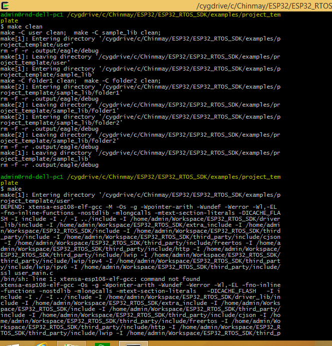

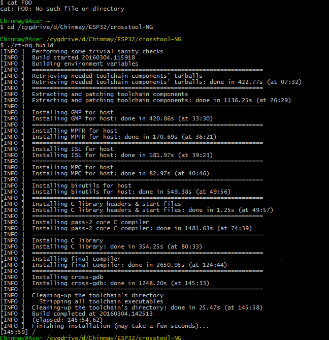

Hey ladyada,
I followed your steps as mentioned on the adafruit link: https://learn.adafruit.com/compiling-a- ... s/overview
and also your video tutorial, and i guess i have succesfully configured the toolchain.
But when compiling i came across some huge chunks of error message when i try to execute 'make clean' and 'make'.
I hv used cygwin64 terminal for toolchain configuration ,I hv attached below some snips of the terminal window which shows the error as well my toolchain directory finishing installation succesfully.
Can any please help me out,i dnt hv any idea what this error might be....
- when i execute 'make clean' and 'make'
- ss_error.PNG (78.94 KiB) Viewed 26505 times
- sure takes some time to install, bt it installed perfectly.
- ss_setup.PNG (47.58 KiB) Viewed 26505 times
Re: compiled windows (64?) xtensa-esp108 toolchain
hi
your path to the toolchain is missing
you can setup it in a batch file before you compile/link
or you can edit/create a system environment for this
or you can append it, when you build the toolchain by registry command
example a other gnu build ( gcc )
and be sure you will then append in the registry too like this
be sure you have installed cygwin.dll in the windows 32 folder too.
rudi
path=your_path_to_your_toolchain;%path%
../binutils-<version>/configure --target arm-eabi --enable-win32-registry=MyToolchainName --prefix /c/gnu/out
[HKEY_LOCAL_MACHINE\SOFTWARE\Wow6432Node\Free Software Foundation\MyToolchainName]
"GCC"="C:\\New-Location"
"BINUTILS"="C:\\New-Location"
"G++"="C:\\New-Location"
rudi
