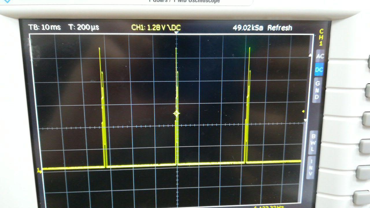

First of all I am totally missing why signal is produced more than once. Image shows that pattern is repeated each ~30ms. Why is that so?
Signal repeated

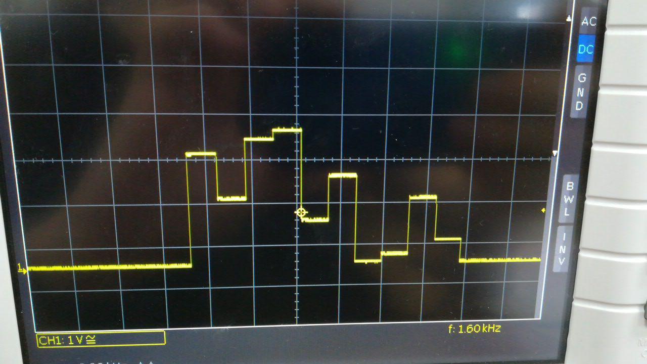

Secondly I am not sure how does I2S interpret sent data, should it be signed or unsigned?
However I tried both approaches(you can see two arrays in my code). What for unsinged pattern, it produces the following output:
Unsigned DAC signal
And here is how it should look like:

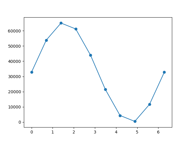

Unsigned sequence how it should be
Clearly sequences of points are not the same.
Could someone clarify what is wrong here?

1. The I2S needs 16-bit samples, you're stashing (repeated) 8-bit samples into it.
2. The I2S reads the samples as 32-bit words and outputs the high 16-bit first and the low 16-bit second. This means that if you want to send it 16-bit samples, you'll need to swap the even and odd 16-bit words.
3. The DAC only plays the high byte of the 16-bit sample as an unsigned value (0..255, not -128..127).
This should (=untested) work:
   static uint16_t sin_samples[SINE_800HZ_SAMPLES_NUM];
    for(uint32_t i=0; i<SINE_800HZ_SAMPLES_NUM; i++)
    	uint16_t samp = i2s_sine_wave_800hz[i] + 32768;
        sin_samples[i^1] = samp; //note i XOR with 1 to swap even and odd samples
    if(i2s_write_bytes(I2S_DAC, (const char*)sin_samples,
            SINE_800HZ_SAMPLES_NUM*2, portMAX_DELAY) != SINE_800HZ_SAMPLES_NUM*2)
        return false;

Sorry for the late reply! Thanks a lot for your answer. I did not test your solution since I have found that ESP has hardware cosine waveform generator which solves the issue easily. Nonetheless thanks!
