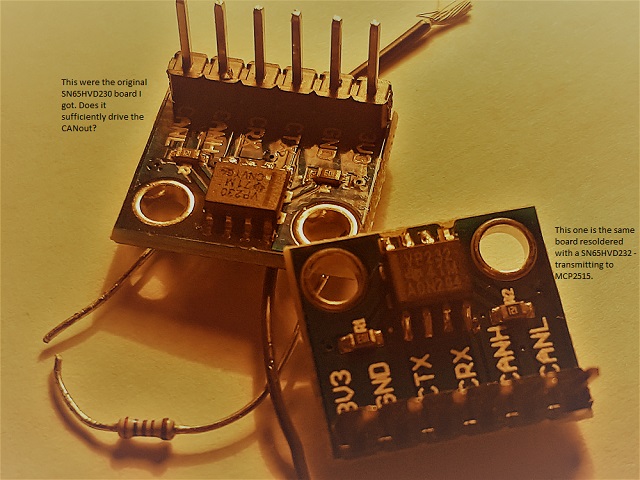

Another update to my issues with sending frames (Tx) from my ESP32.
I came along exchanging the Transceiver SN65HVD230 (CJMCU-230 - Devboard Ali-ordered) with a some SN65HVD232 chips.
This solved the issue for me~! I have stable CAN Rx/Tx now on my very same test setup (it really slept there for the few month). It might be the whole batch(?) of my CJMCU-230 / SN65HVD230 were not matching my network setup (don't know if there are setups they work with, maybe among each. My test were done with a 2nd CAN node, arudino based MCP2515 (5V) Transceiver.)
If I make it to owning my first oscilloscope, then I can also cross-check the transceiver voltage level on bus side again (which in the first CJMCU-230 batch order seemed too low to be recognized by other nodes correctly).

Update 24.04.2019:
"Solved" my problem by accident
Added a second termination resistor with 120Ohm directly to the transceiver. During my first tries, I am really sure, that I did this before. Maybe it was after I played with the CANInit-values and crashed TX with that...
But know it is sending constantly and precise (RX 5 times 10ms messages, TX 1 a 1000ms message).
So, always double check termination

I registered here just to say thank you and to confirm that changing the chip worked for me too.Another update to my issues with sending frames (Tx) from my ESP32.
I spent several days trying to get the 230 chip working in a car with a 128kbit canbus to no avail, it also didnt want to work with a bench network using mcp2515/ja1050 transceiver. I could "listen" to the network, but could not transmit.
Once I swapped it with a 232, it worked perfectly.
I tried changing the resistor on the Rs pin in case it was a slope issue but to no avail.
Hope this helps other people in the same boat.

Be aware that they are some "FAKE" transceiver based on VP230 (SN65HVD230) !!!
I've lost days with 2pcs CJMCU-230 coming from the same supplier on Aliexpress. They were almost working at low speed (125kb) & only for few seconds at 500kb... Forcing High Speed mode with Rs connected to GND did not help really.
Applying another similar transceiver from Waveshare with same VP230 SN65HVD230 with Rs grounded solved all my troubles. Plugg & run! Smooth ESP32 read & writte at 500kb for hours with heavy REC trafic (Rx_PDO1_20ms, Rx_PDO2_1s, Rx_PDO3_5s, Tx_PDO1_1s)
https://www.waveshare.com/sn65hvd230-can-board.htm
Finally I pruchased (1 Euro/pc) 1pc SN65HVD232DR + 1pc SN65HVD233DR
https://www.d4online.com/search?q=can+t ... nstruments
I replaced the fake SN65HVD230 has shown here bellow (thanks Gnatz_):
https://esp32.com/posting.php?mode=quote&f=12&p=35553
Now, both my old transceivers CJMCU-230 are now working well at 500kB (without Rs grounded)
