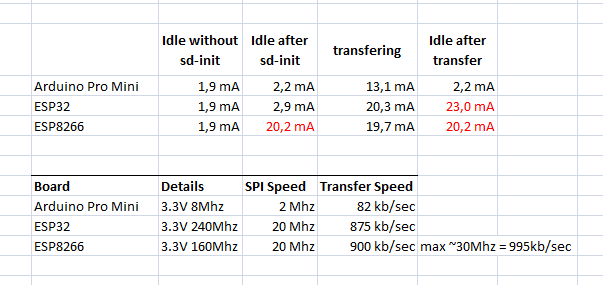

In order to analyze the problem 2 (ESP32 does not react any more), I measured the current, which is consumed by the sd card. So I came to Problem 3:
after initializing the sd card, 2.9mA are needed. Then I open a file and read the data. while reading about 20mA are consumed. After closing the file the sd card (idle) consumes about 23mA (!!!).
I then tested the behavior on an Arduino Pro Mini. There will be 2.2mA after init, about 13mA at the read, 2.2mA after closing the file. so everything ok.
SD Card Power Consumption.png (7.58 KiB) Viewed 8664 times
I do not understand why the sd card after the 1st read always consumes 23mA although not read further. and the consumption is higher than during the transfer.

I had some time today and have the behavior tested with an ESP8266. With the ESP8266 it is even so that after initializing the sd card directly consumes ~20mA (without io access to the card).
SD Card Power Consumption.png (12.58 KiB) Viewed 8617 times
But: the ESP8266 does not hang and can always initialize the sd card.
Can anyone explain why sd cards on an ESP32 / ESP8266 idle consume much more power (compared to arduino) and why the ESP32 often does not initialize the sd card and eventually stops responding?

Could it be that the esp8266 powers up the SD card on init while the ESP32 powers it up on first access?
The 18mA extra draw after using the SD card is probably from it being powered.
If you want to stop that I would assume that you need to power down the SD card and then do a re-init the next time you want to use it.

Thanks for the answer. I would like to have more control over the functions, but I think that does not work with the functions of the SD library. The further, I read audio data (every 2 ms 32 byte for a mp3 module). therefore I can not shut down the sd card for 2 ms.
I still think that there is a bug on the ESP32. Otherwise the ESP32 would not freeze sometime.
