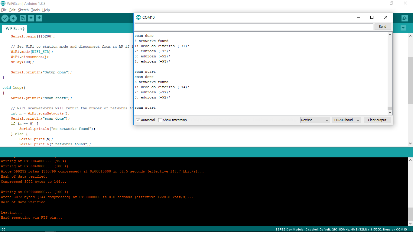

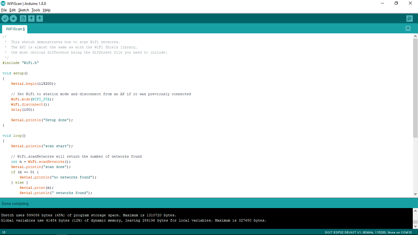

Hi everybody,
I also am trying to use the ESP32 with ArduinoIDE.
I follow the steps of the following video tutorial: https://www.youtube.com/watch?v=hjJx6QOWVkU.
The problem is that when I try to verify the WiFiScan example I just get the same message.
Can, please, someone help me or give me some orientation.

Re: Getting Started
Hey Diogo,
your image does not show an error can you show it?
if it is same as the OP, try the technique above where you press the buttons, if that does not work and you see a blue LED try my method above.

Re: Getting Started
The error was the following:
I manage to upload the example WiFiScan to the ESP32, holding down the boot button before starting the upload and stop holding the boot button after realize that was uploading.
Thanks for the help.
