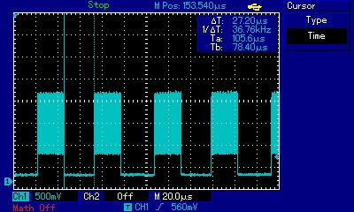

I'm making POV display with APA102C leds and ESP32. I have a problem with long interval between next transactions. Even with high clock rate intervals between transactions kills the projet.

I have struggled with this matter before.
There are a few options to address, and it depends very much on:
What is your data size (Tx) in bytes? (i.g. 3 bytes 0x06 0x00 0x00)
Are they repetitive (same data sent over and over)? (i.g. last 3 bytes to transmit for lets say 3600 times)
Are you expecting any data to be read (Rx)? seems like you don't on your code. If there is, what is the size of it in bytes?
The options to address timings depend very much on previous questions.
The options I may clarify them more if you answer back, and they could be:
-Using no DMA if your tx_data is not long (less than 64bytes)
-Using polling, if you don't mind the CPU being busy while waiting, rather than go do something else.
- Queue transactions if they are the same repeated over and over. This one is tricky, some devices (IC) require status on a pin or channel select between each transaction, but that depends very much on what is the IC you are connecting.
Let me know the answer to my questions in order to help you, I struggled for a specific device and ended up trying (I believe) all possible options.

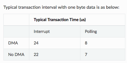

You can use polling as
trans_result=spi_device_polling_transmit(spi_handle, &trans_t);
instead of: spi_device_transmit
You can find the documentation here: https://docs.espressif.com/projects/esp ... aster.html
There you will find what I was describing:
Full example may be found in: https://github.com/espressif/esp-idf/bl ... ple_main.c
Please let us know if you were able to reduce the time with polling and how good was the improving.
I have other options to reduce the timing but it really depends on tx_data size per transmit, if it is constant, and if rx_data is expected.
