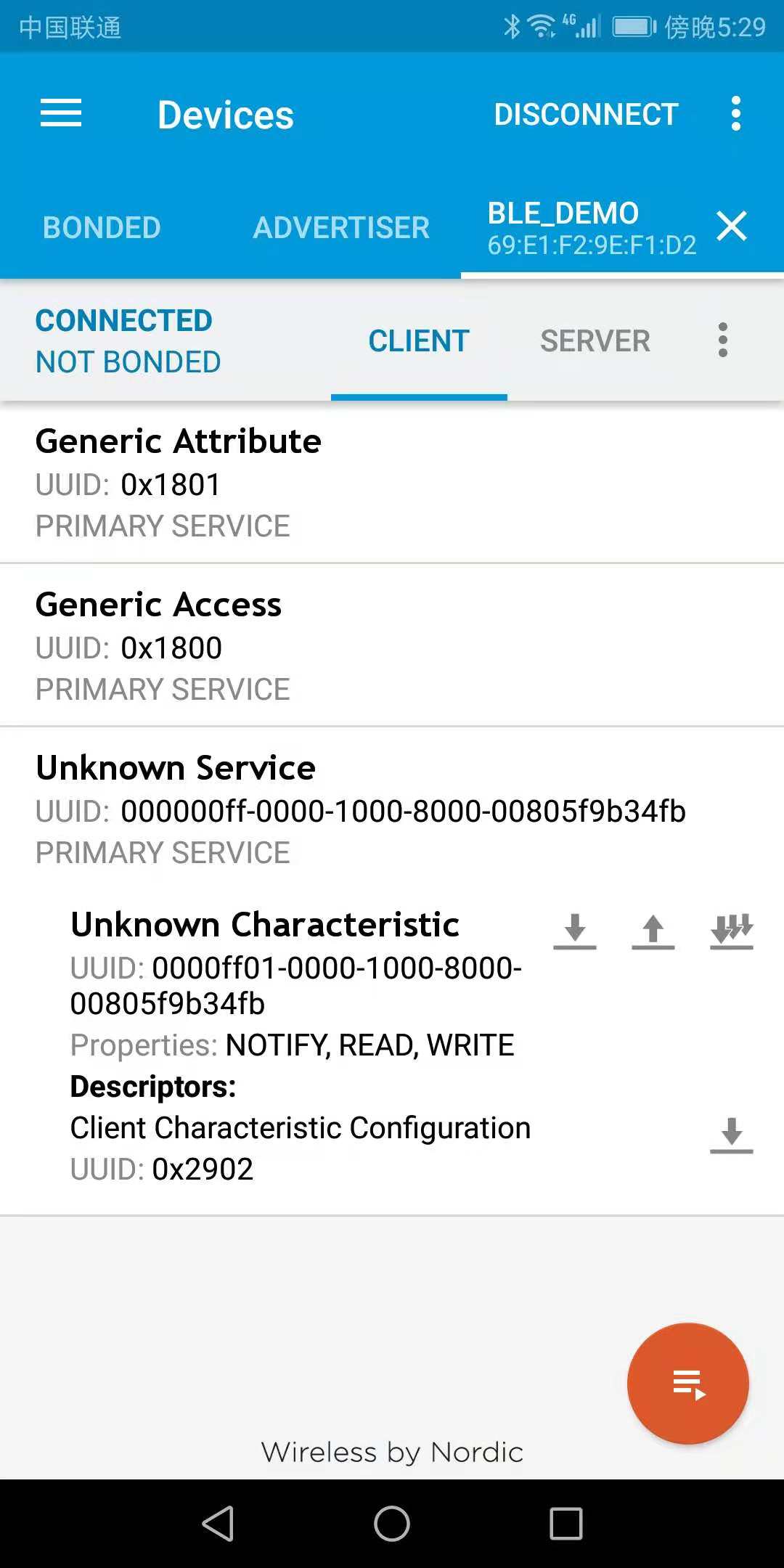

- case ESP_GATTS_CREATE_EVT:
- ESP_LOGI(BT_BLE_COEX_TAG, "CREATE_SERVICE_EVT, status %d, service_handle %d\n", param->create.status, param->create.service_handle);
- gl_profile_tab[PROFILE_A_APP_ID].service_handle = param->create.service_handle;
- gl_profile_tab[PROFILE_A_APP_ID].char_uuid.len = ESP_UUID_LEN_16;
- gl_profile_tab[PROFILE_A_APP_ID].char_uuid.uuid.uuid16 = GATTS_CHAR_UUID_A;
- esp_ble_gatts_start_service(gl_profile_tab[PROFILE_A_APP_ID].service_handle);
- a_property = ESP_GATT_CHAR_PROP_BIT_READ | ESP_GATT_CHAR_PROP_BIT_WRITE | ESP_GATT_CHAR_PROP_BIT_NOTIFY;
- esp_err_t add_char_ret = esp_ble_gatts_add_char(gl_profile_tab[PROFILE_A_APP_ID].service_handle, &gl_profile_tab[PROFILE_A_APP_ID].char_uuid,
- ESP_GATT_PERM_READ | ESP_GATT_PERM_WRITE,
- a_property,
- &gatts_initial_char_val, NULL);
- if (add_char_ret){
- ESP_LOGE(BT_BLE_COEX_TAG, "add char failed, error code = 0x%x",add_char_ret);
- gl_profile_tab[PROFILE_A_APP_ID].char_uuid.uuid.uuid16 = GATTS_CHAR_UUID_B;
- //esp_ble_gatts_start_service(gl_profile_tab[PROFILE_A_APP_ID].service_handle);
- esp_err_t add_char_ret1 = esp_ble_gatts_add_char(gl_profile_tab[PROFILE_A_APP_ID].service_handle, &gl_profile_tab[PROFILE_A_APP_ID].char_uuid,
- a_property,
- if (add_char_ret1){
- break;
gatt_server如何一个服务增加多个特征值

1. 添加不同的char, 建议不要使用相同的UUID
2. 请添加 add char , callback event ''ESP_GATTS_ADD_CHAR_EVT" 事件上来后再添加新的char.

我也碰到同样的问题,esp-idf 3.1.1, 在ESP_GATTS_ADD_CHAR_DESCR_EVT事件中添加第二个特征值, 返回成功,但是实际上没有添加成功。代码如下:
打印的日志如下:
[0;32mI (630) GATTS_DEMO: ADD_DESCR_EVT, status 0, attr_handle 43, service_handle 40
[0m
[0;32mI (630) GATTS_DEMO: add char res 0[0m
[0;32mI (640) GATTS_DEMO: ADD_CHAR_EVT, status 133, attr_handle 0, service_handle 40
[0m
[0;32mI (650) GATTS_DEMO: the gatts demo char length = 0
[0m
[0;32mI (650) GATTS_DEMO: ADD_DESCR_EVT, status 133, attr_handle 0, service_handle 40
请问我应该在哪里调用增加character的API?
- case ESP_GATTS_ADD_CHAR_DESCR_EVT:
- gl_profile_tab[PROFILE_A_APP_ID].descr_handle = param->add_char_descr.attr_handle;
- ESP_LOGI(GATTS_TAG, "ADD_DESCR_EVT, status %d, attr_handle %d, service_handle %d\n",
- param->add_char_descr.status, param->add_char_descr.attr_handle, param->add_char_descr.service_handle);
- if( has_add_character_2 == 0) {
- gl_profile_tab[PROFILE_A_APP_ID].service_handle = param->add_char_descr.service_handle;
- gl_profile_tab[PROFILE_A_APP_ID].char_uuid.uuid.uuid16 = GATTS_CHAR_UUID_TEST_A2;
- a_property = ESP_GATT_CHAR_PROP_BIT_READ | ESP_GATT_CHAR_PROP_BIT_NOTIFY;
- add_char_ret = esp_ble_gatts_add_char(gl_profile_tab[PROFILE_A_APP_ID].service_handle, &gl_profile_tab[PROFILE_A_APP_ID].char_uuid,
- ESP_GATT_PERM_READ,
- ESP_GATT_CHAR_PROP_BIT_READ | ESP_GATT_CHAR_PROP_BIT_NOTIFY,
- &gatts_demo_char2_val, NULL);
- ESP_LOGI(GATTS_TAG,"add char res %d", add_char_ret);
- ESP_LOGE(GATTS_TAG, "add char failed, error code =%x",add_char_ret);
- has_add_character_2 = 1;
- break;
[0m
[0m
[0m

这个一个月有别的事情,所以没上社区。我当时的解决方法是使用gatt_server_service_table例程。gatt_server增加特征值,也是编译成功,但是现象失败。

请参考以下测试代码:

- Posts: 29
- Joined: Wed Aug 09, 2017 6:16 am
Re: gatt_server如何一个服务增加多个特征值
上面的测试代码, 可以直接将 gatts_demo.c 中的代码替换掉, 烧录运行.
service 结构如下:
- service A 00FF
- char 0xFF01
- descr
- char 0xFF02
-service B 00EE
- char 0xEE01
- descr
请注意:
1. add char 或者 descr 的结果, 请在 GATTS 回调函数中 ESP_GATTS_ADD_CHAR_EVT 或者 ESP_GATTS_ADD_CHAR_DESCR_EVT 事件中, 检查 status
2. 如果你想增加新的char 或者descr, GATTS_NUM_HANDLE_TEST_A 或者 GATTS_NUM_HANDLE_TEST_B 的值需要修改.
service 结构如下:
- service A 00FF
- char 0xFF01
- descr
- char 0xFF02
-service B 00EE
- char 0xEE01
- descr
请注意:
