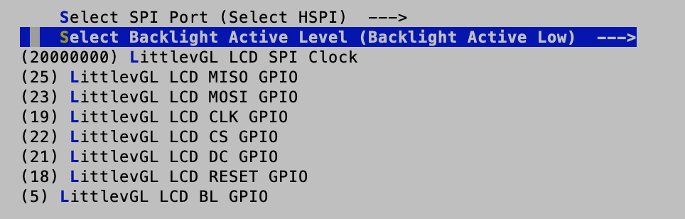

Got it working on the V4 wrover kit with proper Config settings.
There is no need to patch the code and no need to comment out the Touch drivers.
Just disable Touch in menuconfig as well as set the set the backlight active level to low.
All lvgl sample work with these settings.
See below for working wrover-kit board settings. Screen driver is ILI9314

Re: IOT-Solution examples on ESP-wrover-kit V3
Yes, with recent versions of esp-iot-solution (>= January 2019) the code no longer needs to be patched.
@Alen59 To the best of my knowledge no additional resistors are needed. Is the latest version of esp-iot-solution being used and was the menuconfig option "Select Backlight Active Level" set to "Backlight Level Low"?
it started working buy switching back light low and then switch back to high.
