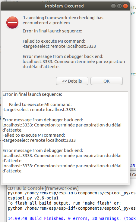

Hi all,
I'm trying to debug my code using Eclipse, I followed the espressif tuto : https://docs.espressif.com/projects/esp ... er-eclipse . I did exactly the same but when I'm launching the debugger I have the following problem :
Error in final launch sequence:
Failed to execute MI command:
-target-select remote localhost:3333
Error message from debugger back end:
localhost:3333: Connexion terminée par expiration du délai d'attente.
Does anyone know why I have this message ?
I'm using Eclipse IDE for C/C++ Developers Version: 2018-12 (4.10.0) with an Olimex-arm-ocd-usb-h and a JTAG cable.
Thank for your time :)

ESP_igrr
Posts: 2067
Re: ESP32 - Debugging using Eclipse
Postby ESP_igrr » Sat Feb 02, 2019 3:51 am
At the time when Eclipse reports this error, what output do you get from OpenOCD?
CalinB
Posts: 15
Joined: Tue May 08, 2018 4:20 pm
Postby CalinB » Sat Feb 02, 2019 7:27 am
Start the GDB first using command:
openocd -s share/openocd/scripts -f interface/ftdi/esp32_devkitj_v1.cfg -f board/esp32-wrover.cfg
Then start the debugging session on eclipse

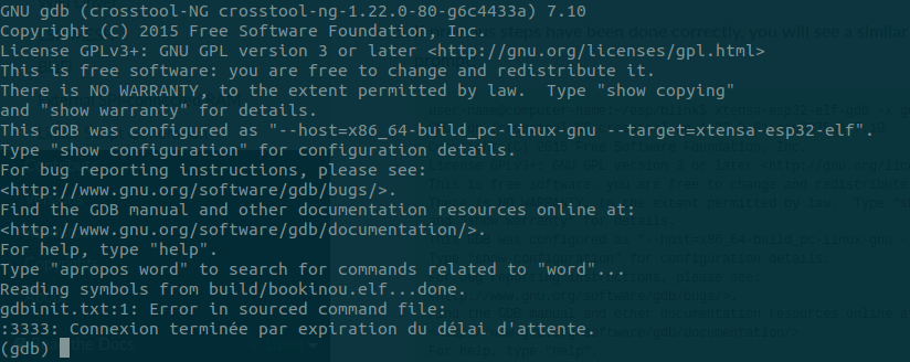

I also try using the command line, and I have the following error :
xtensa-esp32-elf-gdb -x gdbinit build/hello.elf
GNU gdb (crosstool-NG crosstool-ng-1.22.0-80-g6c4433a) 7.10
Copyright (C) 2015 Free Software Foundation, Inc.
License GPLv3+: GNU GPL version 3 or later <http://gnu.org/licenses/gpl.html>
This is free software: you are free to change and redistribute it.
There is NO WARRANTY, to the extent permitted by law.  Type "show copying"
and "show warranty" for details.
This GDB was configured as "--host=x86_64-build_pc-linux-gnu --target=xtensa-esp32-elf".
Type "show configuration" for configuration details.
For bug reporting instructions, please see:
<http://www.gnu.org/software/gdb/bugs/>.
Find the GDB manual and other documentation resources online at:
<http://www.gnu.org/software/gdb/documentation/>.
For help, type "help".
Type "apropos word" to search for commands related to "word"...
Reading symbols from build/bookinou.elf...done.
gdbinit.txt:1: Error in sourced command file:
:3333: Connexion terminée par expiration du délai d'attente. (means the connexion ended because it exceed the wainting time)
(gdb)
I created the gdbinit document as it is written in the esspresif tuto :
target remote :3333
set remote hardware-watchpoint-limit 2
mon reset halt
flushregs
thb app_main
c
Capture du 2019-02-04 12-49-05.png (126.44 KiB) Viewed 14589 times
salomonreinach
Posts: 18
Joined: Tue Jan 08, 2019 11:57 am
Postby salomonreinach » Mon Feb 04, 2019 12:47 pm
CalinB wrote:
Mon Feb 04, 2019 5:11 am
Ritesh wrote:
Sat Feb 02, 2019 1:46 pm
ESP_igrr has asked like what output you are getting into OpenOCD console output while facing this issue. So that we can have idea like what can be issue into your case.
I was giving a solution to @salomonreinach problem on my post.
Please read the posts and posters name before reply :D
Thank you it works with your solution :D
