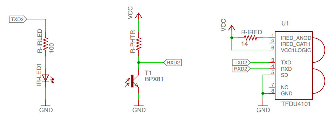

The awesome ESP32 has IrDA support, but how to wire it ? (I can't find any Docs nor further Information about that)
Does it need an "Infrared Encoder/Decoder" (like an MCP2120 with additional Crystal) and a "Infrared Transceiver Module" ?
Or can the ESP32 directly generate the IRTX and decode the IRRX so just a IR-LED and a IR-Phototransistor is needed ?

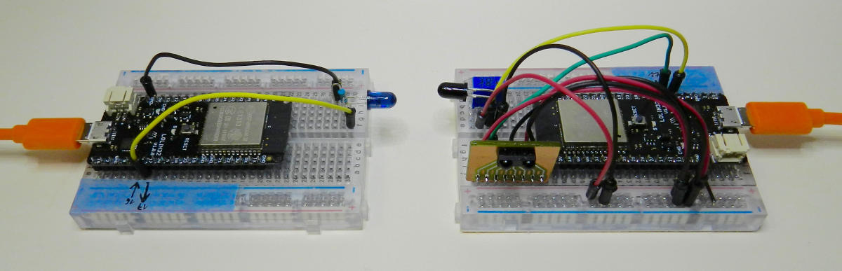

Yes! I figured it out, it's working with just a few additional parts and only 2 Bits to set.
I have a "WEMOS LOLIN32" Board, others are similar but Pin numbers may vary.
For "send only" with Arduino IDE:
And just a Infrared-LED and a Resistor ! That's it !
For receive:
It works with just a Phototransistor and a Resistor !
But use a "Infrared Transceiver Module" (like TFDU4101), that contains a Amplifier, Comparator, some Logic and a Driver for better results.

Infrared has two complete different Modes:
IrDA for Datatransfer in both directions
and TV Remotes, one-way with a modulation of 35 or 38 kHz.
For the TV Remote, just switch the IR-LED on and off that it build the 38 kHz Packet (use delays or a PWM Output).
Use an Oscilloscope (borrow one or ask your local FabLab) with an Phototransistor and (Dummy-) Load Resistor to see what is being sent or to copy the Signals of your TV Remote.
If there is still junk date, check the Resistors, for an IR-LED it's way lower than an usual LED (just 100 Ohm and lower, depends on the Datasheet)
also check the Resistor of the Phototransistor, if the value ist too low, Data High Pulses can't reach full voltage - is it to high, the High potentials can't flush fast enough and jam the Datastream, I got best results with an potentiometer and some Try&Error

Hello Bob,
I tried it first without any IrDA Code, just a wired serial connection with 5V TTL Levels. (Cross Rx->Tx and vice versa)
As that worked, I set it up with a normal LED to see if there is some activity, then I checked it with an Oscilloscope.
Then I set up the IR-LED with R1 = 100 Ohm and R2 = 4.9 k Potentiometer and connected the Oscilloscope to RXD2 and turned the Poti till I got a good signal and then the Data came through over IR
I bought all Boards at once from the same Version and still use them, so I don't know any changes.
Hope that helps !
DD

Hello Q
I guess yes, because I also didn't find anything else.
There is no Library, it's all in Hardware. A Hardware UART that can switch into IrDA Mode by activate the Bit's in the Register.
Got it to work from 5mm up to 3 m with 3.3 Volt and up to 4 m with 5 Volt on the TFDU4101.
Hope that helps.
DD
