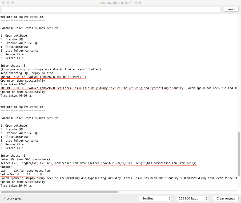

Shox96 is a compression technique for Short Strings. It can achieve upto 65% compression. This technique is available for compressing text columns in SQLite for ESP32 in the repository https://github.com/siara-cc/esp32_arduino_sqlite3_lib.

Screenshot:
