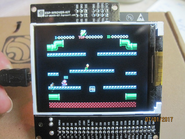

hi
cause tested with ESP32 WROVER KIT V2 ( black )
found out, that we must change a small thing.
https://github.com/espressif/esp32-nese ... _lcd.c#L53
/*orig WROVER KIT 1 ( red ) Backlight active high! */
// #define LCD_BKG_ON()    GPIO.out_w1ts = (1 << PIN_NUM_BCKL) // Backlight ON
// #define LCD_BKG_OFF()   GPIO.out_w1tc = (1 << PIN_NUM_BCKL) //Backlight OFF
/*rudi mod 06 jan 2017 on WROVER KIT V2 ( black ) Backlight active low! */
#define LCD_BKG_OFF()    GPIO.out_w1ts = (1 << PIN_NUM_BCKL) // Backlight OFF
#define LCD_BKG_ON()     GPIO.out_w1tc = (1 << PIN_NUM_BCKL) //Backlight ON
txs for your great work Jeroen!
now i need a PS1/PS2 Controller :mrgreen:
i usually do not play ;-) so sorry for this i have not PS1/PS2 controller here :oops:

a2retro
