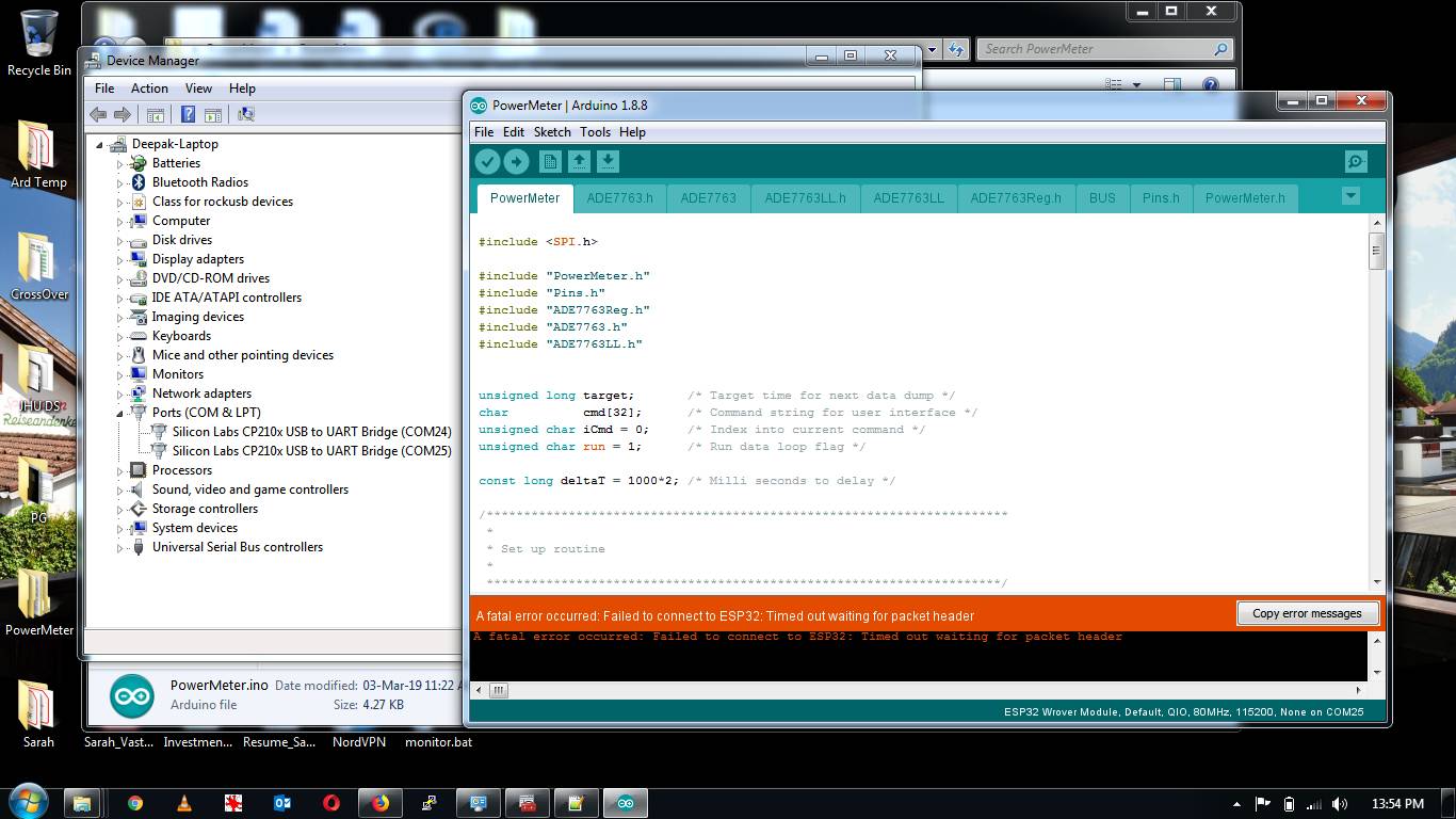

I have a WROOM32 board (Not LoLin). I tried the below:
1. Pressing boot button as soon as I click on Upload on the IDE
2. Pressing the "BOOT" button when I see "Connecting ..." on the Arduino IDE
3. I connected a 100nf capacitor across the BOOT button (with difficulty) as per https://github.com/espressif/arduino-esp32/issues/333
4. When I see "Connect", I press BOOT and then EN, wait for 3 seconds, release EN and then release BOOT.
5. Connected a 10uF/10V capacitor across EN and GND and followed the procedure for BOOT pin (not EN this time)
Everytime I get the same Timeout error as shown in the attached image.
I tried it with another board and it worked. I'm just not convinced that the board which is giving me problems is gone bad. Any ideas what could be wrong? Might be I can install a separate FTDI breakout to make it functional again.
Regards,
Deepak

Re: Unable to upload ESP32 code - Invalid head of packet (0x1B)
Thanks idahowalker. Will try powered USB hub and see if that helps.
Thabks karansoi. I have the 30 pin version of the WROOM32 dev board which doesn't seem to have a breakout for GPIO0, which prevents me from forcefully connecting it to the ground.
I am not sure if the BOOT button is connected to GPIO0 or not.
Anyone has any ideas to breakout GPIO pin from the board that i have?

This isn't something we're aware of. What development boards are you buying? Are you in the habit of exceeding the specifications (voltage, etc) on a regular basis?Also, ESP32's blow quicker than a fuse.
To get more hints about what might be going wrong with the device, try opening a Windows Command Prompt and running esptool.exe directly with the --trace option. Something like this should work:
C:\Users\Deepak\AppData\Local\Arduino15\packages\esp32\tools\esptool_py\2.6.0/esptool.exe --chip esp32 --port COM24 --trace flash_id
