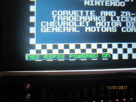

hi guys,
what you think?
can we save ROMS to sd card (yes )
make a menue for selecting from this ( yes )
after select, ROM cpy to nmap (yes )
is no sdcard found, load "factory" 0x10000
return romdata (yes)
perhaps we can nmap sdcard (raw) too (usually yes) 8-) vfat? :idea:

..But copying from SD into flash and mmap-ing the flash is certainly doable.
yes , first steps now it works from sdhc now too, txs ivan.
play with a menu just in time for simple selection and load the next game :mrgreen:
if esp_sprite too busy at the time for sound... i will try this next time too, but not sure how this comes in steps.. must read in deeper first.

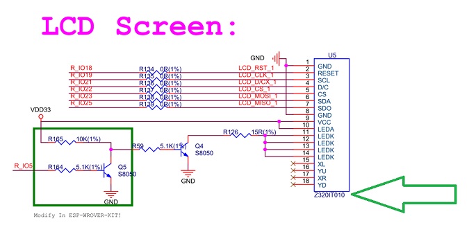

hi
cause tested with ESP32 WROVER KIT V2 ( black )
found out, that we must change a small thing.
https://github.com/espressif/esp32-nese ... _lcd.c#L53
/*orig WROVER KIT 1 ( red ) Backlight active high! */
// #define LCD_BKG_ON()    GPIO.out_w1ts = (1 << PIN_NUM_BCKL) // Backlight ON
// #define LCD_BKG_OFF()   GPIO.out_w1tc = (1 << PIN_NUM_BCKL) //Backlight OFF
/*rudi mod 06 jan 2017 on WROVER KIT V2 ( black ) Backlight active low! */
#define LCD_BKG_OFF()    GPIO.out_w1ts = (1 << PIN_NUM_BCKL) // Backlight OFF
#define LCD_BKG_ON()     GPIO.out_w1tc = (1 << PIN_NUM_BCKL) //Backlight ON
txs for your great work Jeroen!
now i need a PS1/PS2 Controller :mrgreen:
i usually do not play ;-) so sorry for this i have not PS1/PS2 controller here :oops:
see a sequenze on twitter
The screen looks great, what is the LCD size of this one? And what model is it? Thanks
Posts: 1759
Re: NES emulator on an ESP32
Postby rudi ;-) » Mon Mar 27, 2017 3:58 pm
hi
if you lookup in the pdf shematic of wrover
you see Z320IT010 and it is a 240RGBx320 3.2" screen sheet from here
hope this helps
edit:
look up 1
look up 2
